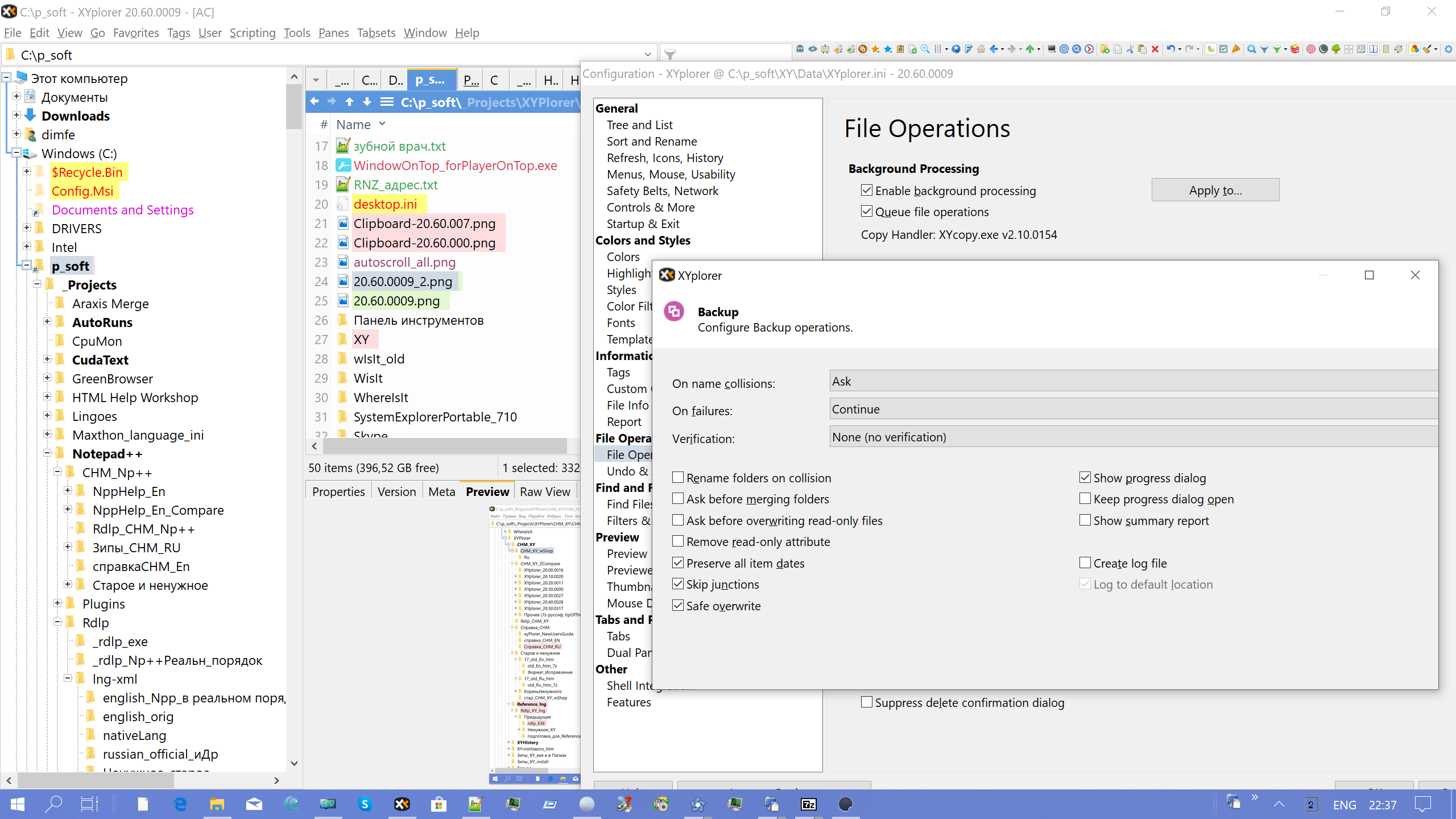

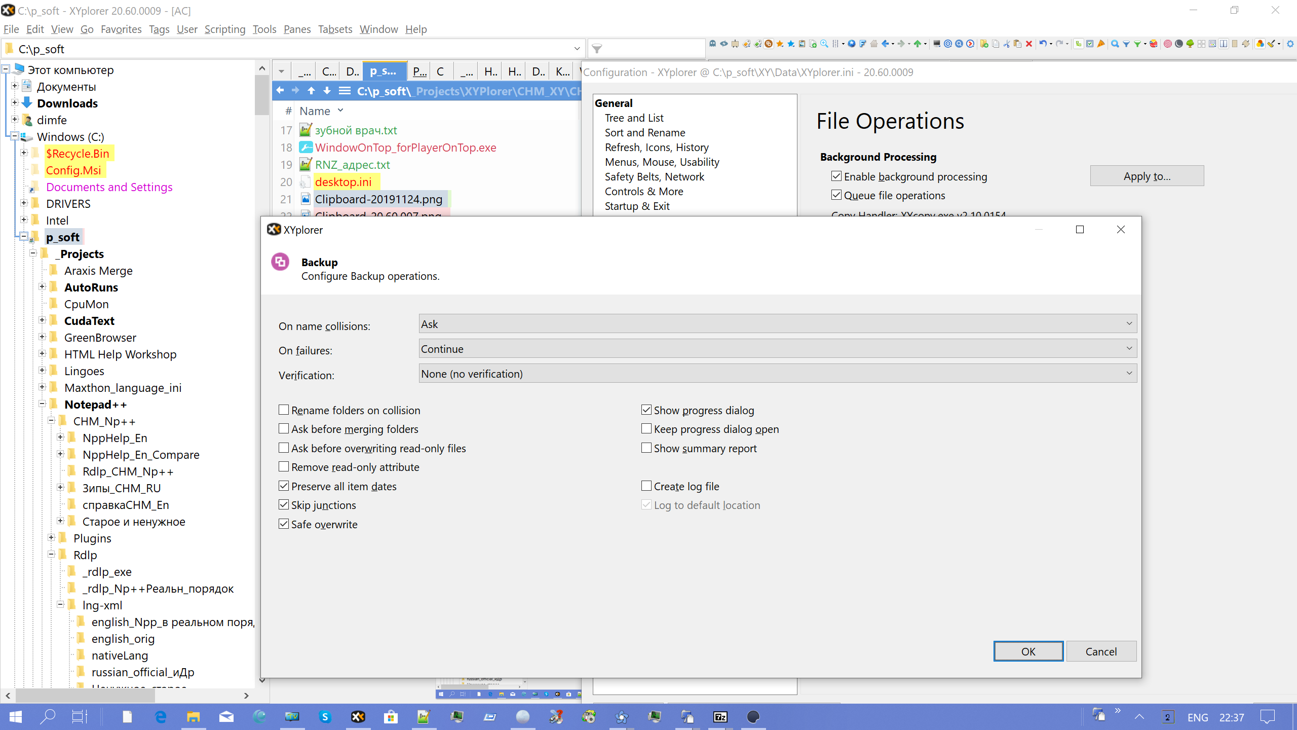

problem is not fixed. (Screen DPI: 160 (166,666666666667%), twx: 9, stretch: 1,5)-the same in 20.60.0009
But I'm not sure the problem comes from this place.
Example from window (#711; check for updates) This is the size of this window.
.. This size should have the same window so I can see the OK button.
The same with configure.. window: --------------------------------
For the purity of the experiment I installed separately version 20.60.0000 as a trial version and then updated to version 20.60.0009
The picture is the same.
Unfortunately I can't check concretely in which version after 20.60.0000 it started.
In the directory ... XY\Data\Temp saved only the latest version.
But I can see that you have worked with "Auto Scaling On Different Resolution Screens" since version 20.60.0001
In addition, in version 20.60.0009 tips to some toolbar buttons do not match what should be.
For example, the configuration button = Floating preview and when you click on it, the configuration dialog does not appear.
And in not trial installation configuration button has name Dual pane (F10) and makes Dual pane
- Posts: 67026
Re: Russian
Oh yes, I saw it now at 175%. It was a rounding error due to a new way to determine the DPI per monitor (which ultimately failed). The next beta should really fix it. Thanks!

Re: Russian
v20.60.0011
In those places where I have checked all is OK.
Screen DPI: 180 (187,5%), twx: 8, stretch: 1,5. As before

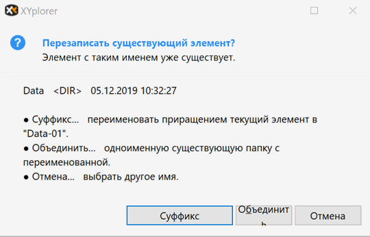

info-pane/Find Files/Date/_Date Picker
Dialog "Overwrite Existing Item?" button "Объединить" = [messages].M&erge
- Posts: 67026
DmFedorov
- Posts: 722
- Joined: 04 Jan 2011 16:36
- Location: Germany
Re: Russian
Both fixed. Thanks.
