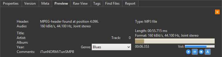

Does it look like this in the Preview Tab?
- PreviewTabMP3.png (8.86 KiB) Viewed 3999 times
Re: Audio Preview - Strange behaviour
No, not even close in my case. It's just a windows media player gui.

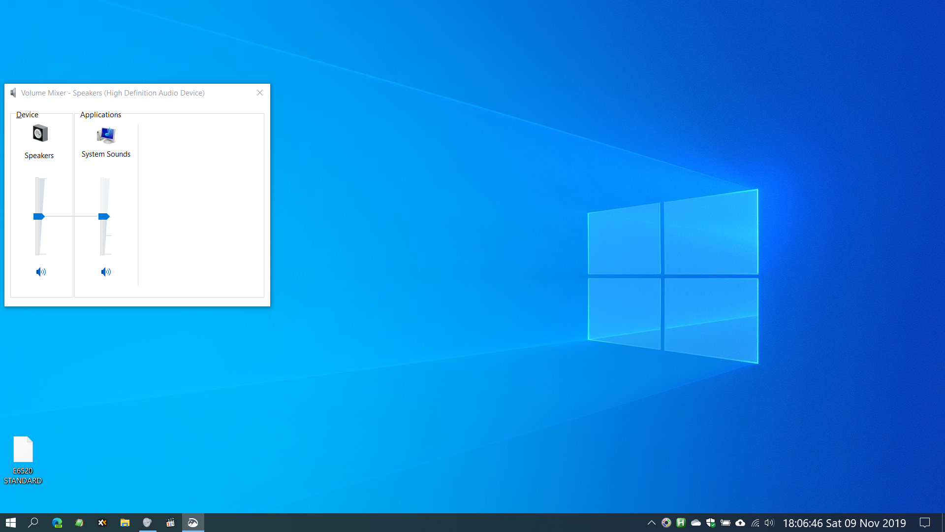

Here are some screen shots.

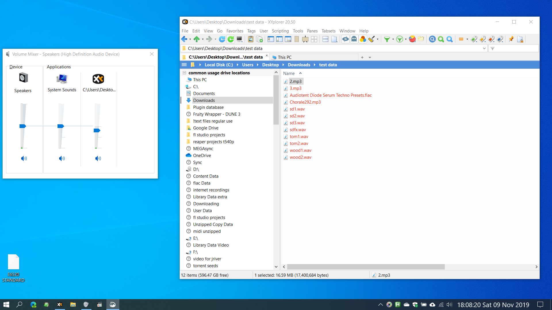

1 just windows volume mixer open
2 now open xyplorer (no preview window)
3 now autoplay preview an mp3 (no preview window) volume lowers

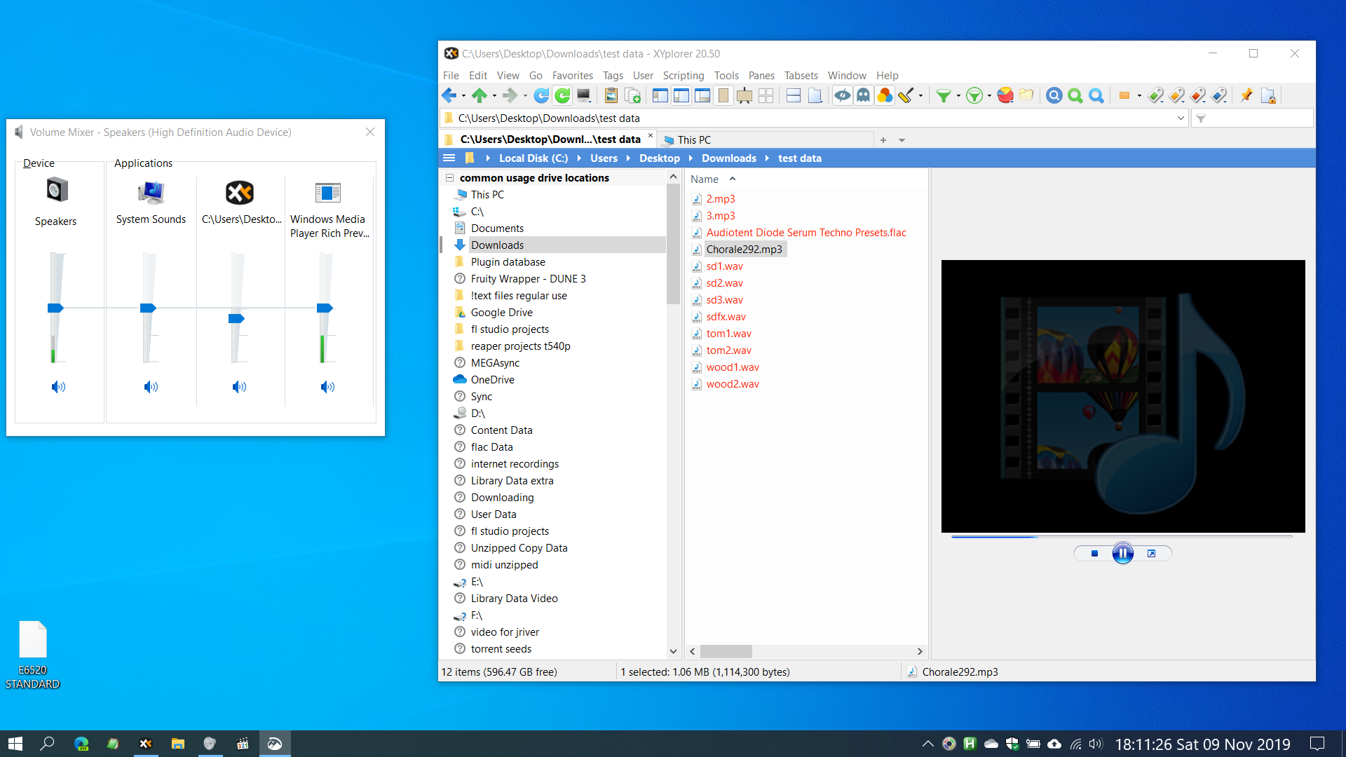

4 now with preview window open (it wouldnt autoplay, i had to press the button), volume doesnt lower
5 now after closing the preview window, volume doesnt lower (I hadn't raised it again from the last time it lowered)
