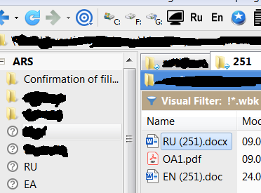

I attached screenshot how I use it, I select file and press button above "Ru" or "En" and file turns into RU ($current_Folder). Thanks to your script! But I would not figure it out how to code it, because the coding language for xyplorer is somewhat unintuitive and the help file lacks real-life examples. Really, one would think that there should be just a $current_folder variable, coz every file is inside some folder, and stuff like gpc(<curpath>, "base") is unintuitive. At least it is possible to add a remark in the rename command description, that gpc can be used for renaming... that would point me out to a right direction, but there is no any clue in the current help file.
