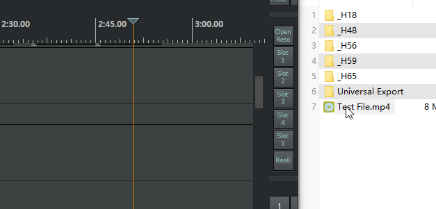

Oh.. Just to say this problem happens in my computer as well.
Windows 10 64-bit, XYplorer 19.30 - I don't know if it's 32 bit or 64 bit, actually I didn't find an "64 bit version of XY" in the website.
And FYI, in some programs when I try to drag a file many times, it could success sometime. Which makes me much more confused :veryconfused:
In the Gif I'm dragging a video from XY to REAPER (64 bit).
HOWEVER, when I try to drag a text file into Sublime text, it never success. :shock:

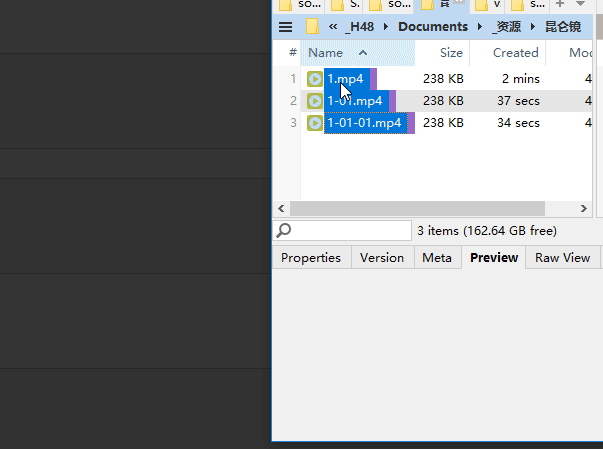

Hi I found a strange thing and I think maybe it's the KEY to solve the drag problem!
Firstly, see this gif:
Under these condition, the drag problem is probably happen:
1. Select multi files.
2. Open the Preview Pane.
When close the Preview Pane, dragging behavior became normal :appl:
