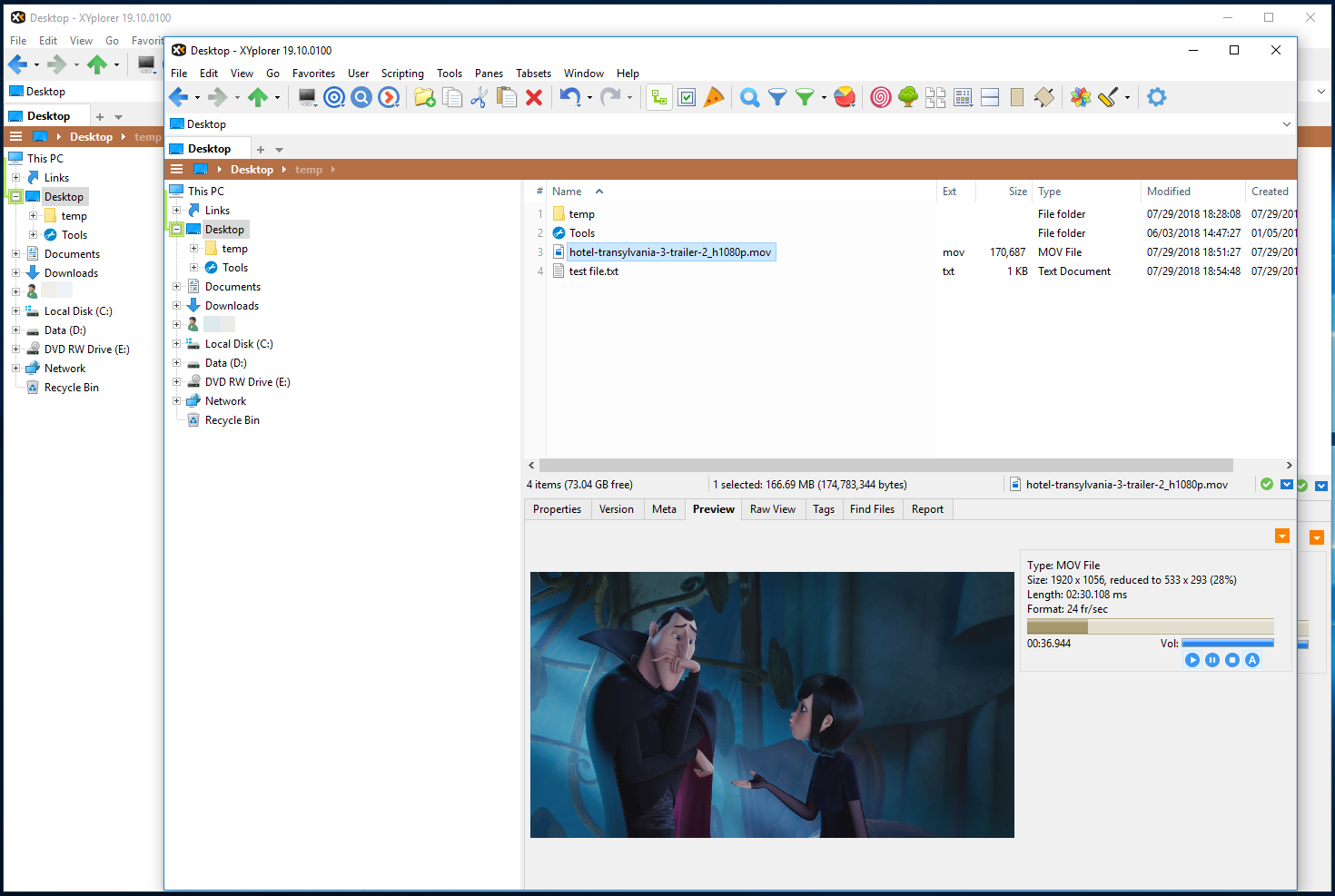

I probably found a bug in video preview overlay. On my laptop all is working perfectly, but on my desktop I have the following issue:
When I start XYplorer and click on the video, I can see it is starting (sound is working) but nothing is displayed in the preview pane
I have a similar behavior in the info panel if I close the preview pane
If I move to raw view (working) and go back to preview, it looks the display is not refreshed
I order to get the correct behavior I have to start a second instance of XYplorer. In this one preview pane is working
And same for info panel preview
I was thinking initially that is was a codec problem and tested a lot of things but, after a a long investigation, it looks to be related to the nvidia video driver. I tested 3 latest driver versions and it the the same, except when I totally uninstall it, just before the reboot (I think windows is using a generic driver at this point). The version I'm currently using is 398.36. My system is a windows 10 Enterprise x64 v1803 fully patched.

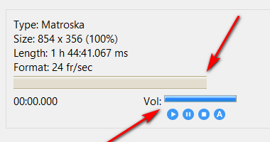

Slightly off topic, so sorry to interject but since the OP has already posted screenshots here that can be compared with mine, I thought here was a good place to ask, does anyone else see the alignment issues I have pointed out in the below screenshot, I am running Sergoe UI 9 for B&L @ 120 DPI if that is relevant.
- Posts: 66860
Re: video preview overlay issue
Yes, these are some of the few elements that cannot scale. One day I will have to redesign this panel.jupe wrote:Slightly off topic, so sorry to interject but since the OP has already posted screenshots here that can be compared with mine, I thought here was a good place to ask, does anyone else see the alignment issues I have pointed out in the below screenshot, I am running Sergoe UI 9 for B&L @ 120 DPI if that is relevant.

I confirm it is still happening, even in version 19.10.0200. This can be reproduced with any video file (size and extension doesn't matter), it could be avi, mov, mp4 ...
I tested it on different computers each time with an NVIDIA card as primary device (GeForce 9XX or 10XX) and always reproduced the problem. With a laptop using an intel as primary GPU and NVDIA as secondary, all is fine.
I also tested all nvidia drivers:
windows update nvidia driver is 391.25 -> OK
v 391.35 (from nvidia site) -> OK
v 397.64 -> not working
v 397.93 -> not working
v 398.11 -> not working
v 398.36 -> not working
v 398.82 -> not working
Best regards,
