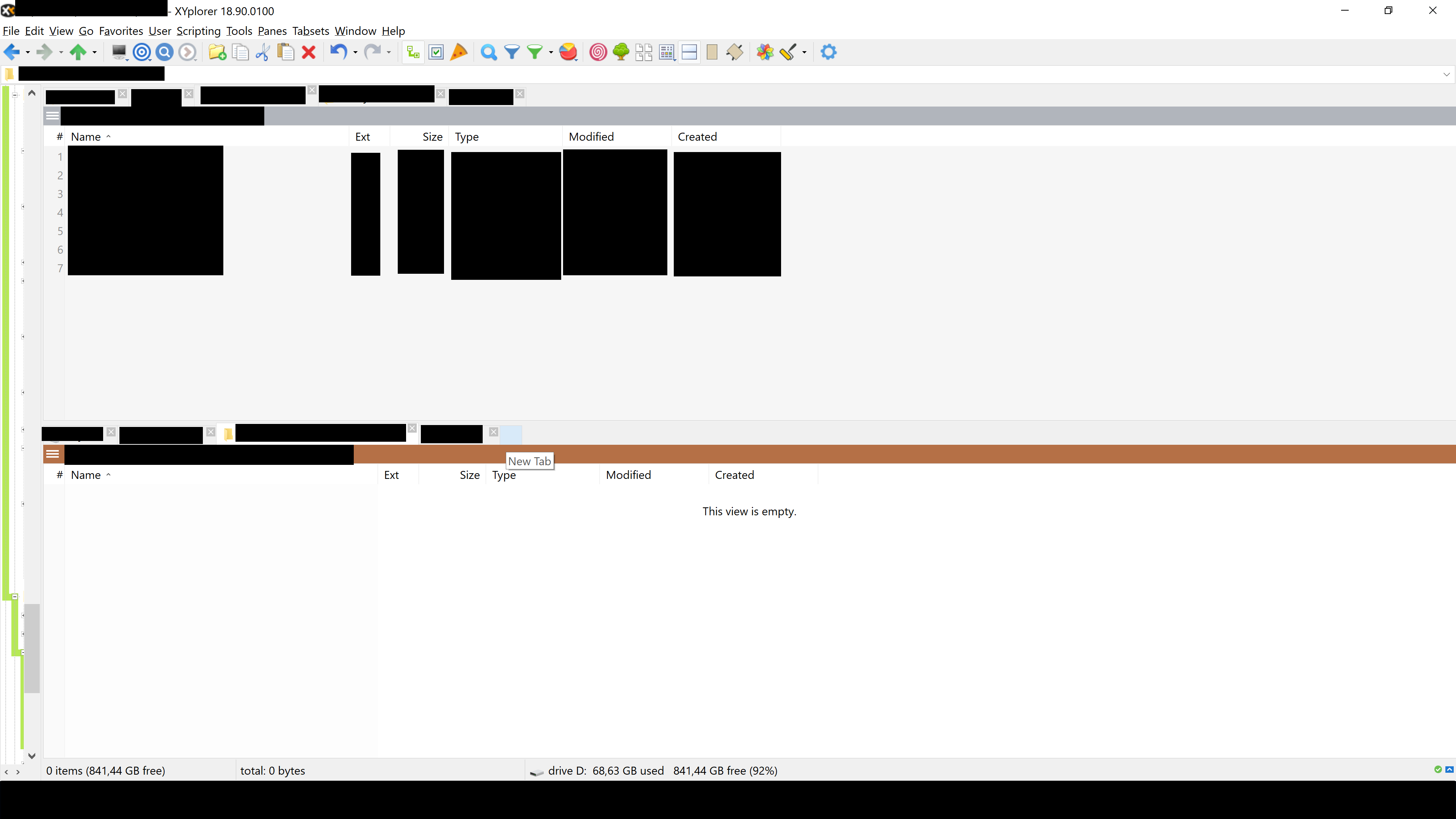

As the subject says, i can't see neither the new tab icon nor the tab list icon.
I'm running XYplorer 18.90.0100, on windows 10 x64
NOTE: in the picture the cursor is not shown, but actually it's on the New Tab button.
NOTE2: I have the tab list button active, but as the new tab icon it's not visible.
- 1.png (138.3 KiB) Viewed 4718 times

Thanks for the quick answer, but unfortunately I have them actived. In the image you can notice that in the second panel, near the position where the "new tab" icon shoud be, there's a label saying "New tab". To explain it better: I can click the button, and it works just fine. The problem is that the icon is not shown, but the button it's still useful, so the problem is only the icon.serendipity wrote:Welcome!

This may sound silly, but you could try upgrading to latest beta via the help menu and see if it fixes itself because I have never heard of or seen this happen before, did you download XY from the website or a 3rd party?

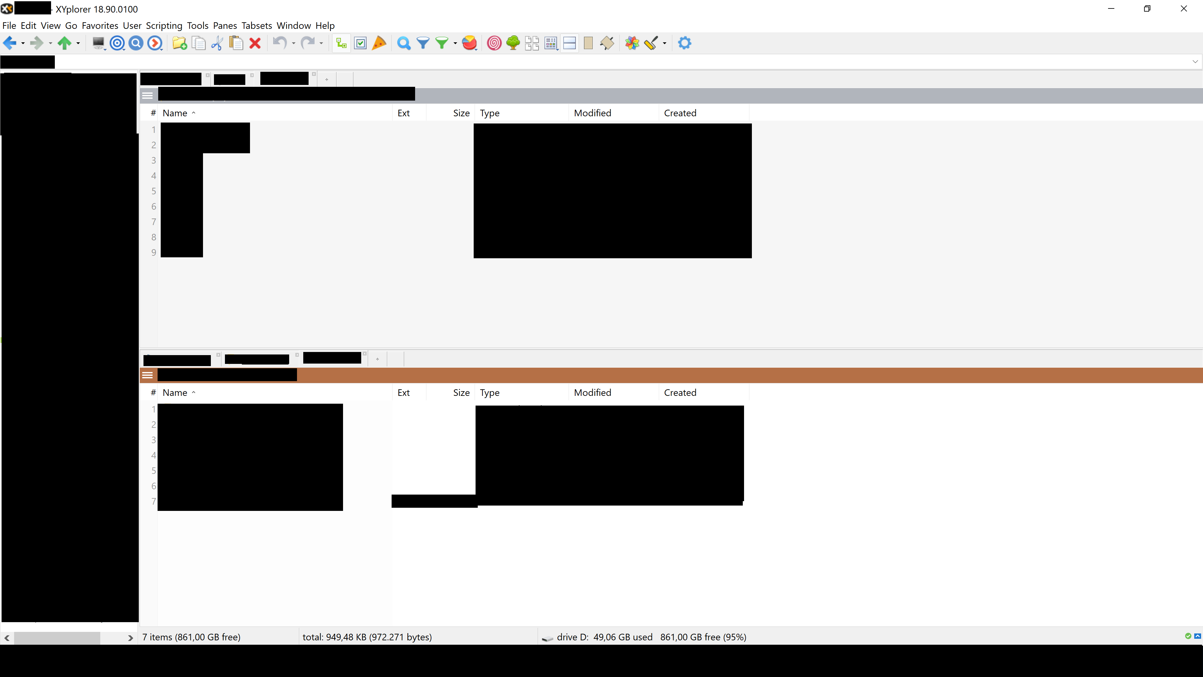

Thanks to your idea, I think I'm closer to the source of the issue:
I have a 4k window on my pc. The problem is that many apps doesn't adjust their interfaces to 4k, so I need to manually kind of force adaptation, by creating a shortcut on the desktop and: properties > Compatibility > Override high DPI scaling behavior, and then I try with Application, System and System (Enhanced), and Ieave the one that seems to be the best. With XYplorer, trying Application is the same as do nothing. Trying System and System (Enhanced) produces the same result: both icon are shown (new tab and tab list icons), but the interface is destroyed, as you can see in the picture.
I know that the issue is outside the domain of XYplorer, but I truly appreciate your ideas.

I didn't try your idea exactly as you said, but I managed to get to a solution.
I activated the override dpi option, and then with Ctrl + Shift + MouseWheel and Ctrl + MouseWheel I adjusted the interface as I had before, so problem solved.
