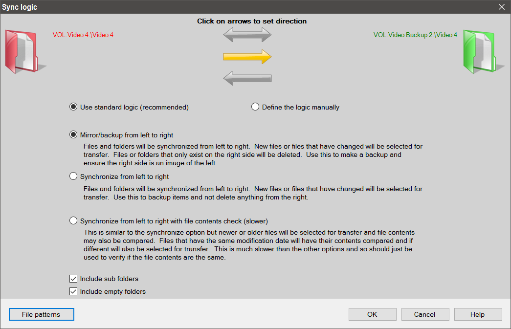

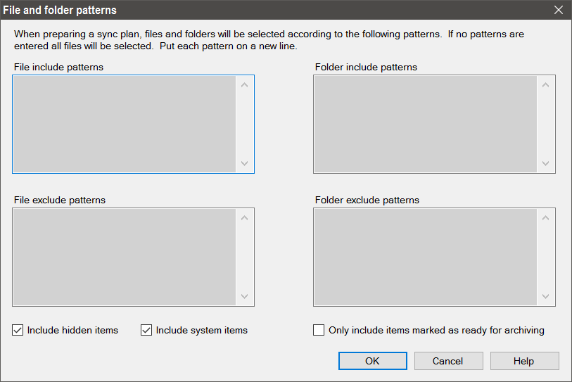

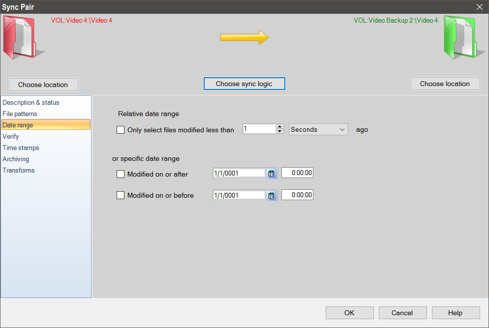

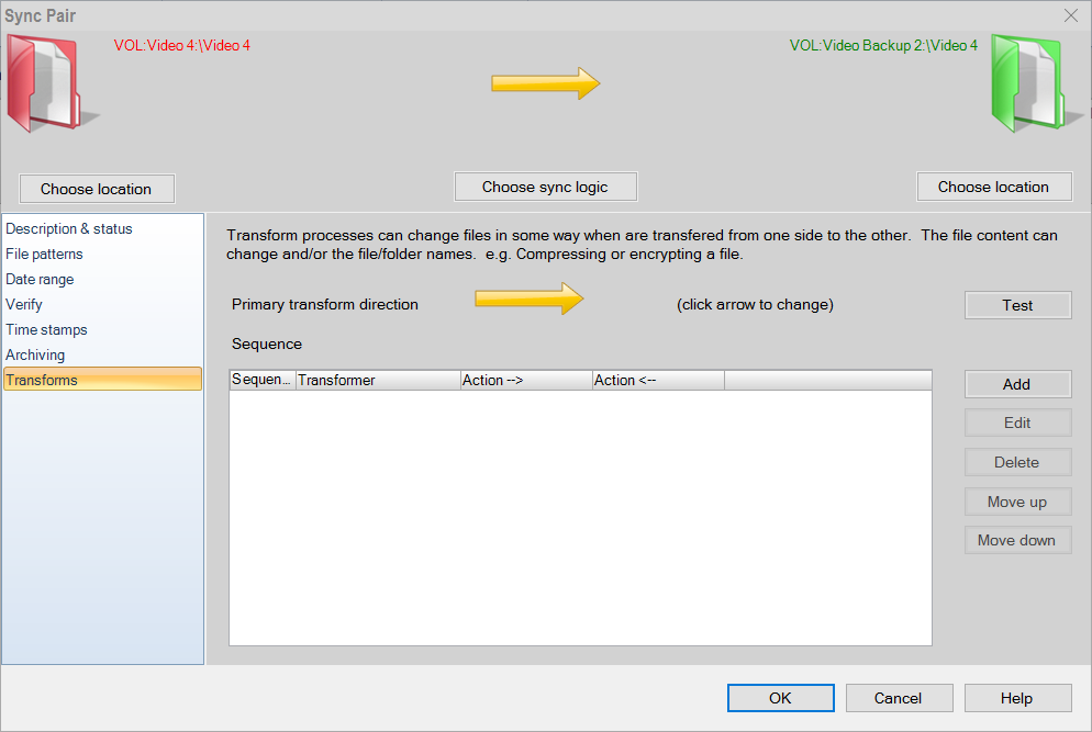

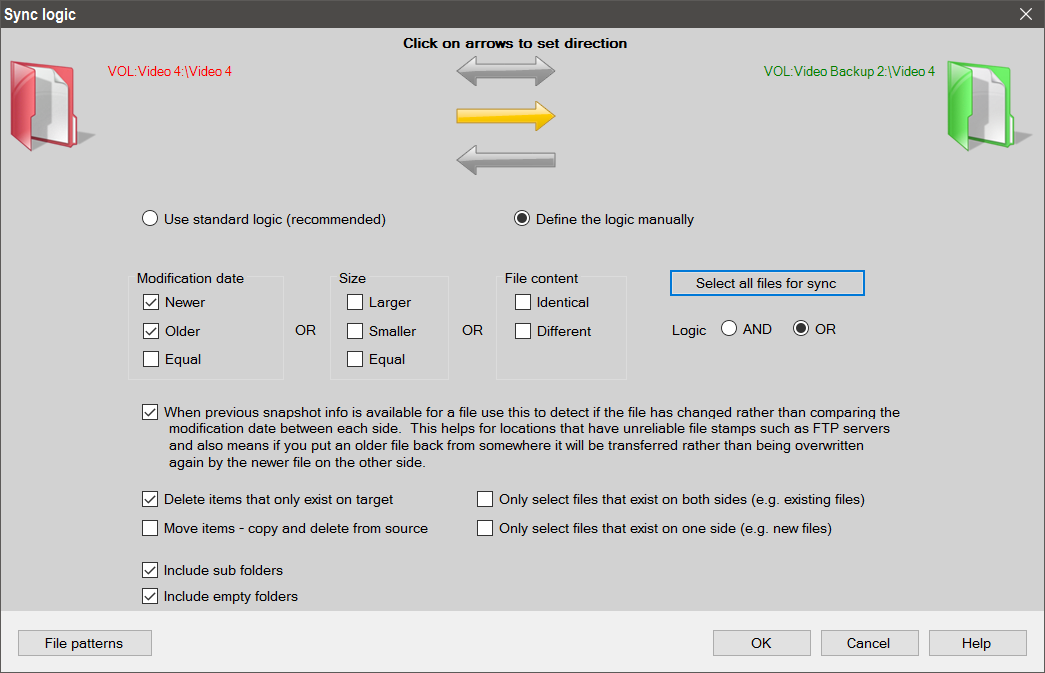

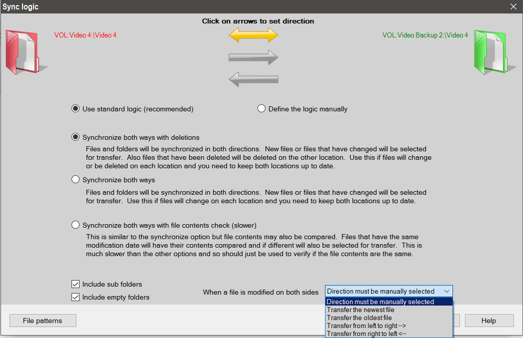

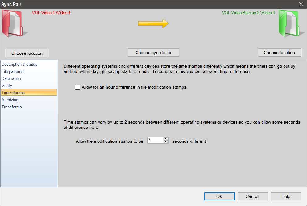

I have long used AJCSync for my synchronization needs, for entire drives. So FWIW (no doubt more than FWIW), below are screen shots of the configuration panels.
Standard Logic (Left to Right)
Standard Logic (Both Ways)
AJCSync-standardLogic (BothWays).png (69.52 KiB) Viewed 4592 times
Manual Logic
File Patterns
Transforms
Date Ranges
Time Stamps
Running on Windows 10 Pro 64-bit quad-core ASUS G752-VY notebook with 64 GB RAM, over 26 external USB3 drives attached via multiple powered hubs with letters and mount points, totaling 120+ TB. SCREEN SCALING: 125%
