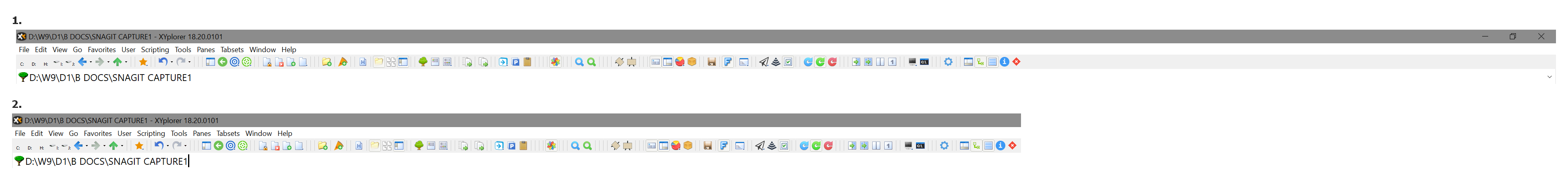

I for one would like to be able to double the current size of icons and have a distinctive 'red' border
for any icon that is depressed.
Attached is a copy with two images. One is full length of the 4K screen.
Not sure if this can be shown here.
I'm lucky to have two 4K monitors and I have complained before that it is next to impossible
to see if a toolbar button is depressed or not and there are other problems.
- TOOLBAR IN 4K C^ 7-08-15_5293.jpg (428.43 KiB) Viewed 2231 times

Right click XYplorer.exe, "Properties", "Compatibility" tab?
Re: XYplorer does not scale properly on secondary monitor
Found a fix for the toolbar size.
How about a fix for the line directly above the toolbar <File to Help line>.
That text size needs to be doubled also.
How?
How?
- C^ 7-08-21_5353.jpg (129.49 KiB) Viewed 2199 times
