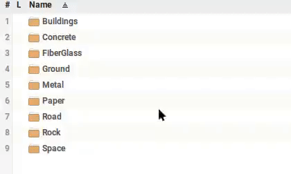

Hold the Left Mouse Button, don't move the mouse and AHK sends a "Ctrl+Shift+Alt+Num /" key combo.
Map "Ctrl+Shift+Alt+Num /" to any command for example
[*] Open with (main reason I made this)
[*] Run script
[*] Run a script w/c does different things depending on what's under the cursor (maybe, haven't tried it)
Here, I've mapped "Ctrl+Shift+Alt+Num /" to "open with (#176)". (gif is made with pre v1.00)
Due to reasons, I've made the Ahk script auto-terminate when you close xyplorer.
So you might want to setup a way to launch this together with xyplorer (I use the cmd-line arg /script= ).

Hi sheeeple, thanks for this. Your AHK script works quite nicely with my old script WhiteSpaceContextMenu. Which brings up a different menu depends on the file type selected. In the original script, if you have a file selected and single right click in the White Space of the list, a menu displays depending on the file type - all customizable of course to ones own needs. I put my WhiteSpaceContextMenu script in the User Defined Commands under load script with the keyboard shortcut of Ctrl+Shift+Alt+Num Divide and it worked like a charm without having to do anything to it. I just wanted to pass that on because you mentioned that possibility.

klownboy wrote:Hi sheeeple, thanks for this. Your AHK script works quite nicely with my old script WhiteSpaceContextMenu. Which brings up a different menu depends on the file type selected. In the original script, if you have a file selected and single right click in the White Space of the list, a menu displays depending on the file type - all customizable of course to ones own needs. I put my WhiteSpaceContextMenu script in the User Defined Commands under load script with the keyboard shortcut of Ctrl+Shift+Alt+Num Divide and it worked like a charm without having to do anything to it. I just wanted to pass that on because you mentioned that possibility.
Thanks,
Ken
Thanks for the tip man, I appreciate it.
Also, I can't believed I missed those tweaks (CEA stuff :shock:). I probably would've just used those instead of making this script, haha.
