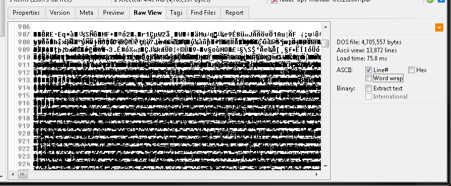

This isn't a really a problem, just a weird behavior with the "Raw View" that I thought was notable.
On certain files with really long lines, they will wrap back over the top of themselves.
This all goes away when "word wrap" is selected.
attached image of what it looks like.

- wordwrap.png (34.65 KiB) Viewed 1159 times

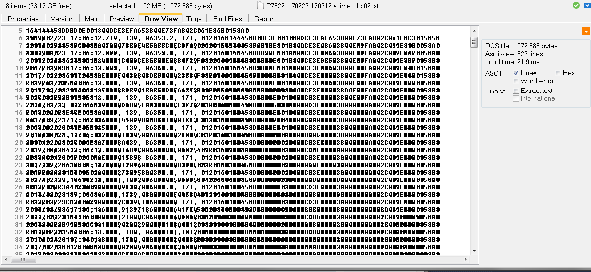

Ok, I can now repeat the problem again but I was able to do it with a much simpler file. It's basically a UNIX formatted text file. (End of lines are line feeds only rather than carriage return line feed combos.) But the files have to be pretty large still. This one was just a bit over 1 MB in size.
I can attach it if you want to take a look. But I think it's easy to create a file like that. Each line was generally between 104 and 108 characters and only delimited with a line feed.

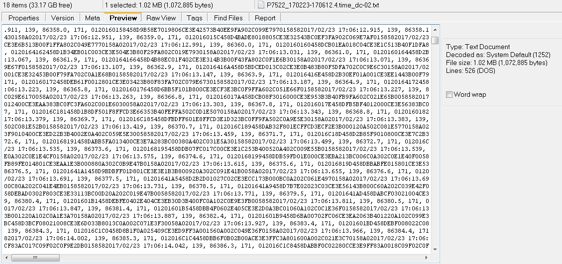

Here is the same file in the Preview tab.

Made such a file but could not repro the problem. Please send me yours. (support at xyplorer.com)

A slight nuance to the file I didn't notice right off, but the very first line did have a cr/lf, but the rest of the lines were all linefeed only. That may be what throws it all off.

Thanks for the file! Yes, the mixed line endings were indeed causing the trouble. Got it sorted now.
