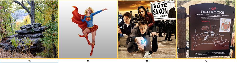

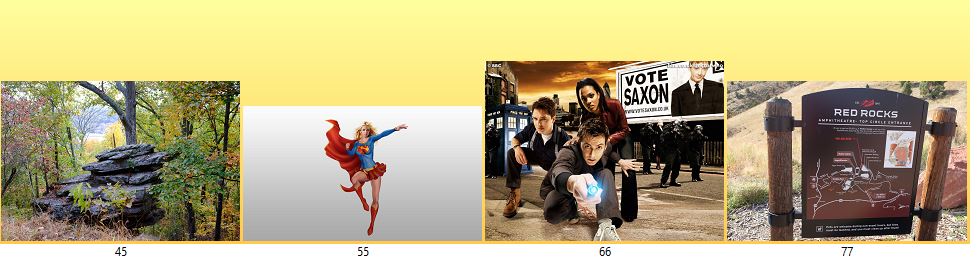

This script will generate thumbnails for all your subfolders (not files) under the current folder in a Zoom to Fill mode. See the example differences below.
- It randomly selects a image in each subfolder.
- The new thumbnails will be called folder.jpg. Any existing folder.jpg files will be renamed not deleted.
- The size of the thumbnail for the subfolders will be auto detected based on thumbnail size assigned for the current folder times a multiple 4 (default), though the multiple can be "1" (see $multiple below).
- First, go to the main folder where you have subfolders under it (e.g., G:\Wallpaper or H:\Photos).
- Ensure the view is a thumbnail viewing mode more than likely you would be or should be via a Folder View Settings or tab.
- If not in a thumbnail mode the script will exit with a message. I purposely did not want to force a specific thumbnail view here.
- Taking advantage of Don's new parameter for SC SaveThumb for 'Zoom to Fill'.
