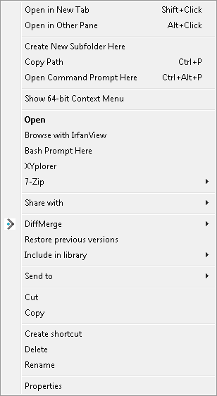

Ok, this is something I can try. So far I've had a window open for several days and the only thing I haven't done is any right clicks on anything to bring up a context menu.
Any other window I had open I've gotten it to crash pretty quickly in some way if I do a right click on a file or in the directory tree. I don't even need to select on item on the context menu. So far I can get a crash on a window if the ONLY thing I do is right click on a file. So, I'm happy about getting closer to the actual cause.
I have the ShellExView program and I can now make changes to the shell items but I would like to show you what my context menu look like for additional context. In the mean time I'm going to keep trying by disabling items. Thanks for this tip.

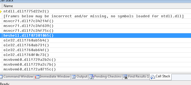

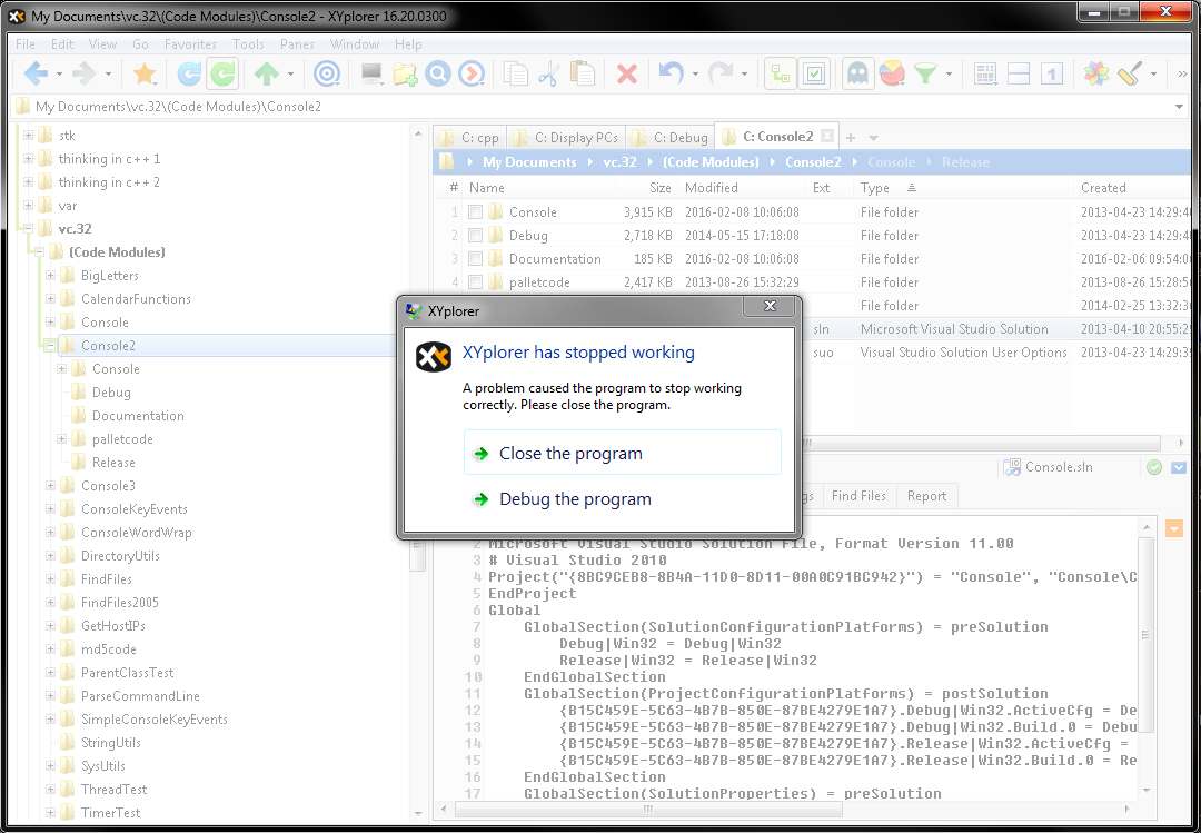

I found something!
I hit the "debug" button instead of "close" to see if visual studio could show me any clue of what shell extension I could try to disable first. What I found was unexpected. The DLL in the call stack pointed to an obscure hex editor I used to use that was still on the computer. (HHD Software Free Hex Editor 3.12) It had been on there for years. It's possible that a recent OS patch may have exposed a bug in it that has been causing problems. The odd thing is that it has never shown up in the context menus. I uninstall the editor completely rather than disable it in ShellExView because I never use it. I'm going to continue to watch for crashes.
I'm feeling confident sofar that this may be fixed now.
heshell.dll
xy crash.png (104.49 KiB) Viewed 1751 times
xy call stack.png (10.29 KiB) Viewed 1751 times
