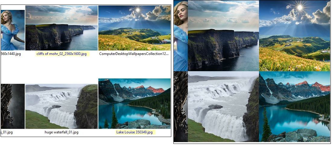

The script title pretty much says it all. I got the itch to do this because of the request in this thread here. It's a simple script which will allow you to set up folders of your choosing to view the image thumbnails in a Gallery mode. By Gallery, I mean the thumbnail view where you'll have: no padding (no gaps), Plain Style (no border), no Captions, and "Zoom to Fill" is ON (see the picture below). Well, you say I can do that already. Yes, you can, but you can't have both styles. Zoom to fill, padding, captions, no border options are across the board. This script will allow the user to set up some image folders for thumbnail viewing settings totally different from his normal setting. For example, my normal thumbnail configuration is with thumbnail Padding set to "1", Captions are ON, and I have "Zoom to Fill" option OFF. This script allows me to view thumbnails for the same (or different) image folders in the Gallery mode (i.e., no gap, no border, Zoom to Fill ON.). Out of the box this is not possible in XYplorer since the "Zoom to Fill" style thumbnails require a different cache. A folder's thumbnail cache is based on the folder thumbnail size and whether the "Zoom to Fill" option is ON or OFF.
Thumbnail Normal mode (left) vs Gallery mode (right).JPG (127.55 KiB) Viewed 5943 times
Basically the script relies on a new modified version of the XYplorer.ini file, I've called XYplorer_Gallery.ini and a separate thumbnail cache folder "GalleryThumbs". This way we're not tampering with the "normal" XY thumbnail folder. A second instance of XY is started using the XYplorer_Gallery.ini file and XY will make new caches in the GalleryThumbs folder. You may want to give some thought as to which image folders you'll want to see in the gallery mode obviously since new caches are made for the image folders. As is the case normally, when you first enter the folder it will take time to generate the new thumbs and of course that depends on the amount and quality of the images and the type and size of thumbnails. The cache is generated behind the scenes do give it for the 2nd instance to display. Another benefit of using this method is that you can if you'd like have totally different size thumbnails specified than what you have in the "Normal" comfiguration (XYplorer.ini). You can have this new instance of XY come up in a larger size or even maximized or adjust other settings like background color. These types of adjustments you can do on your own by modifying XYplorer_Gallery.ini or by making adjustments in the Configuration while in the second instance (you'll see the name of the ini file being modified at the top of the Configuration dialog box - to be sure the proper ini file is being changed).
It will take a few minutes to set it up, but once done, you'll be able to view your thumbnails in a gallery mode with no padding, caption or borders. If you have your normal thumbnail configuration is already set that way, you could have just the opposite arrangement (i.e., have the new thumbnail viewing mode display thumbnails with captions and gaps and borders. The point is it gives you the flexibility to have it both ways. If you'd like, you could also modify other viewing or arrangement features in the new mode like have completely different thumbnail sizes, no navigation panel, no tabs bar, no toolbar, and even the backgroung color.
