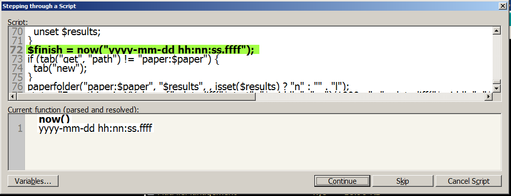

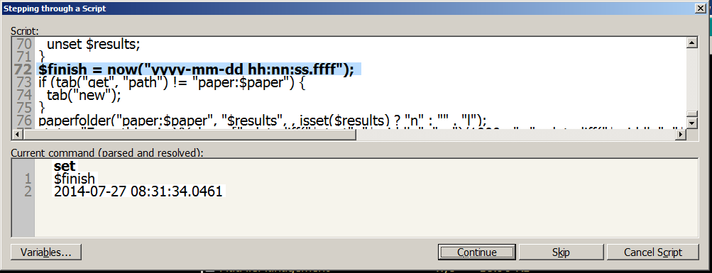

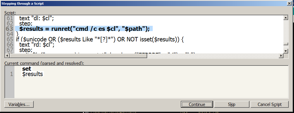

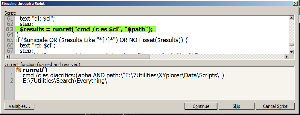

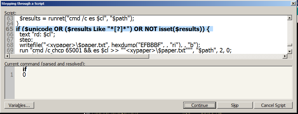

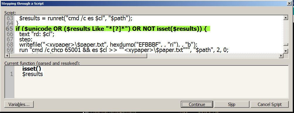

binocular222
Posts: 1421
Joined: 04 Nov 2008 05:35
Re: [β] Everything in XYplorer — Rev. 0.96 / 2014/07/24
Post by binocular222 »
Last try with your debug: the stepping dialogs are as below:
dl: diacritics:(abba AND path:\"E:\7Utilities\XYplorer\Data\Scripts\")
Last try with your debug, the stepping dialog are as below:
still some more but i guess that's enough to debug?
