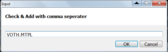

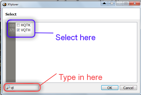

I don't know if this will be any help but here goes.
     $AtaglistA = taglist();
     $choice = inputselect("Select ", $AtaglistA, ",", 2); // see  Image1.png
     $YrTags = input("Check & Add with comma separator", , $choice, , ) ;  //see list.png
     tag "$YrTags", , 1;   // tags your selected file(s)
     taglist("$YrTags", 1);  // adds new tags to taglist
I tested this with an unsorted taglist of 1000
1/ select item(s) you want to tag and run script.
2/ (see image1.png) type your tag in box highlighted in red.
3/ (see image1.png) select from list. if not in list can be added in step 6.
4/ repeat steps 2 & 3 until finished.
5/ click OK.
6/ (see list.png) check that all required tags are in view if not add a comma then your tag
conntinue adding comma and tags.
7/ click OK.
the script will then tag your item(s) and update the taglist.
