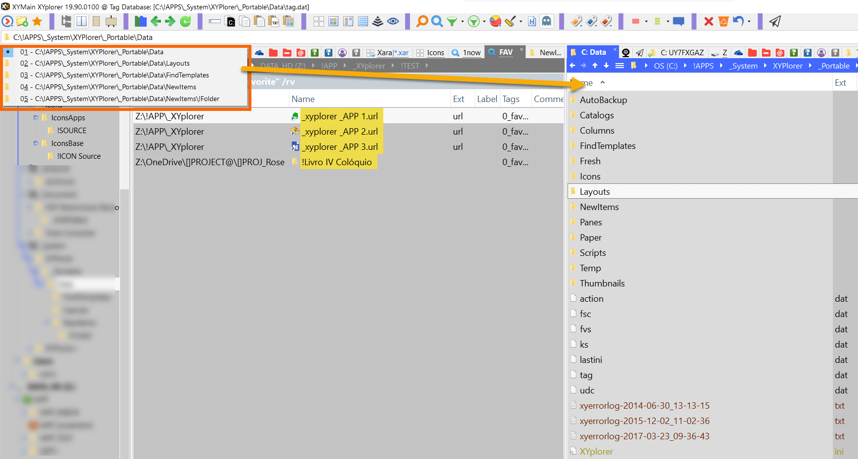

I'd appreciate your help.
I set a shortcut for the command "Tab History (#345)".
If the tree is ON when I press the shortcut, "Tab History" list pops-up on the tree (see snapshot).
If the tree is OFF when I press the shortcut, the list pops-up on the active pane, which is the way I need always, even when the tree is ON.
So, is it possible set "Tab History" to pop-up always on the active pane, even when the tree is ON?
Thank you!

Up to now, when I attach a shortcut to the command "tab history", every time I press the shortcut the pop-up window appears only over the tree, not considering the active pane.
