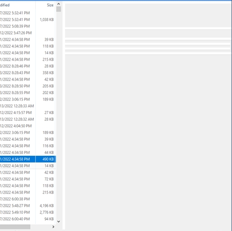

On version 23.70.0200 for me, previewing a .MSG Outlook file (32 bit Office 365) - Preview pane stops working (mouse is unresponsive in pane) when you switch to previewing other files. You also get a flash of a .msg preview when you switch to another file in the preview pane. Only fix is to restart XYPlorer.
• Word preview still works
• Going between MSG + PDF does not work
• PDF – not working with PDF Editor shell & Foxit shell
msg flash.jpg (55.8 KiB) Viewed 3682 times
pdf preview non-responsive.jpg (5.79 KiB) Viewed 3688 times
scrollbar corrupted.jpg (5.54 KiB) Viewed 3688 times

It 'works' as in it shows up, but I can't drag the preview pane scrollbar after the first .msg file & same for PDFs.
So it's actually not usable especially when I want to copy + select text from within that .msg preview pane.
This is using the MS OUTLOOK .msg handler, not the MsgPreviewer64 handler (which I can't use because it takes focus from the list pane whereas the Outlook handler keeps focus to the list pane so you can use up/down arrows to go to next file).
So when you say you're both using the msg handler, are you using the Outlook handler, or that 64 bit third party version?
