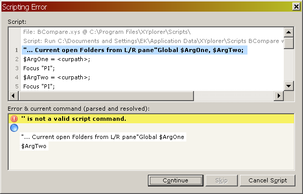

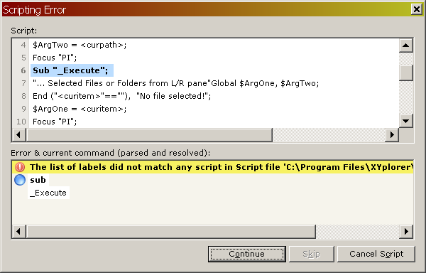

and a couple of the error windows:
seems it hiccups at the " mark?
At the end it gives your message about "Bcompare.exe not found, edit script and check path"

OK, just looking at your script. Don't know if i can work it out right now.
First mistake i have seen already:
Syntax rules for XYplorer Script Files
1.) The first line of an script has to start at column 1.
2.) Only the first line of an script starts at column 1. All others starts at column 2 or more.
3.) If an script has an "Caption" (or an "Label" for multi-script scripts) then this label has to start at column 1, instead of the first script line, which starts at column 2 or more then.
I think this part is missing in the help at "Syntax rules for XYplorer Script Files"
So Emil should remove the spaces before the captions like
    "... Current open Folders from L/R pane"
    "... Selected Files or Folders from L/R pane"
and so on.
