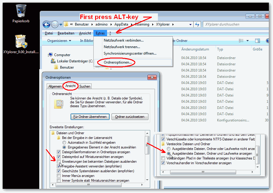

Note that this folder may be hidden, as well as the file extensions (as .ini)
To make them visible, press ALT-key and go to "extras > folder options" > "View"
As an alternative setup, to leave all data-files inside the xyplorer folder,
you can give "Modify" rights for "Users" to the "...\program files\xyplorer\" -folder: In that situation you doesn't need the startup.ini at all. Simple rename it to startup.txt.
