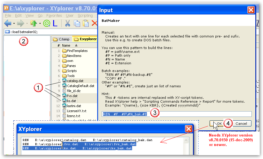

Purpose:
		Script to create an text file with an collection of all seleted files
		and with common prefix and suffix for each line.
How to use:
    1. Select a few files
    2. run this script
    3. modify the output line with placeholders and literal text
    4. press OK and you will see an text with all selected files, incl. all expanded placeholders and your literal text

   $Desc = "Manual: ";
   $Desc = $Desc . "<crlf>   Creates an text with one line for each selected file with common pre- and sufix.";
   $Desc = $Desc . "<crlf>   Use this e.g. to create DOS batch files.";
   $Desc = $Desc . "<crlf><crlf>You can use this pattern to build the output lines:";
   $Desc = $Desc . "<crlf>   #F = path\name.ext<crlf>   #P = Path only<crlf>   #N = Name<crlf>   #E = Extension";
   $Desc = $Desc . "<crlf><crlf>Batch examples:<crlf>   ""REN #F #P\#N-backup.#E""";
   $Desc = $Desc . "<crlf>   ""COPY #F .""";
   $Desc = $Desc . "<crlf>Other examples:<crlf>   ""#F"" or ""#N.#E"", create just an list of names";
   $Desc = $Desc . "<crlf><crlf>Hint:<crlf>   This # -tokens are internal replaced with XY-script tokens.";
   $Desc = $Desc . "<crlf>   Read XYplorer help > ""Scripting Commands Reference > Report"" for more tokens.";
   $Desc = $Desc . "<crlf>   Example: ""{name}, {size KBR}, {Created yyyymmdd}""";
   $Input = Input("BatMaker", $Desc, "REN   #F   #P\#N_bak.#E");
