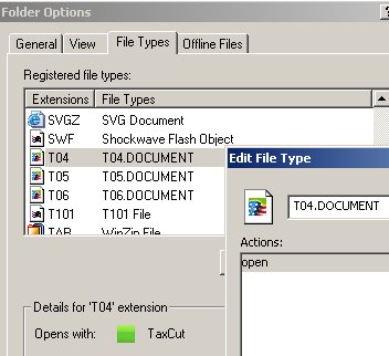

For ref, here's what one file looks like in Properties in both WE & XY: Note also the difference in the base icon itself...This file is for a tax preparation software and the desktop icon for 2004 & 2005 vers was the flag thingy and in 2006, just a green box...here's what shows in File Types which is not consistent either as you can see:
- File type display for T04 type
- SS - 09-25-09 @ 23-09-53001.jpg (28.91 KiB) Viewed 2743 times

So the Properties look different in WE and XY? Hm, I did not know this was even possible! This dialog is made by the Shell, not by XY... Stumped.j_c_hallgren wrote:Funny that you should mention this...as I tried out the free vers of Mozy some time ago and did a backup and then realized that I didn't want the system overhead so turned off the process...and then forgot about it...looked at some files in Win Expl later and wondered what those green checks and red x's were...Duh! It's Mozy status flag..
