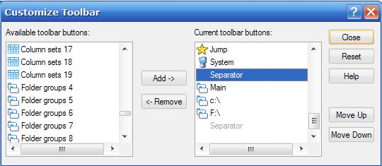

Are you only allowed to have one toolbar on the window? That seems pretty limited. Why can't you add as many as you want? You can't even add a lot of toolbar buttons to the toolbar because they won't fit on the window. The least you could have done is made it wrap to the next row. Also the large toolbar buttons are a little too big and the small icons are way too small IMO.
Yes, XY is presently limited to one toolbar...it's never really been an issue and has some GUI design implications if there were more...about wrapping, that has been discussed here recently http://www.xyplorer.com/xyfc/viewtopic.php?f=5&t=4704 and icon sizing has also been the topic of some recent posts.

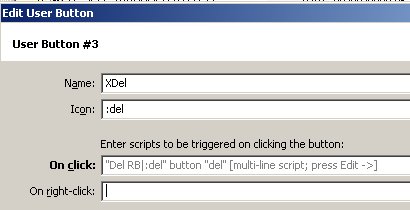

I would like a delete button that deletes the file without sending it to the recycle bin but still gives you a confirmation prompt. The nuke button seems like an accident waiting to happen.
You can use the Shift key with the Del to get that (presuming you've set the confirm opt in Config)...or you can create a custom TB buttom with that command ID (#170)
To help you out, here's a sample of what can be created for a CTB:
And since the script is multi-line, here's what it might look like:
This gives the two methods of deleting on one TB icon with the ability to select your choice on left-click.
One of the reasons to have buttons is so you don't have to use the keyboard. Otherwise you could say the same thing about the Nuke button. Why have one? Just use Shift and Del and turn off confirmation.
Maybe that's fine for the experienced power user but most people aren't going to know what commands or scripts to type in.

This is why allowing only one toolbar is a serious limitation. You should be able to create as many toolbars as you wish and place them whereever you want. You should be able to save the tab groups right to the toolbar and then go into the toolbar customization window and order them however you like. This is how it's done in xplorer2:
