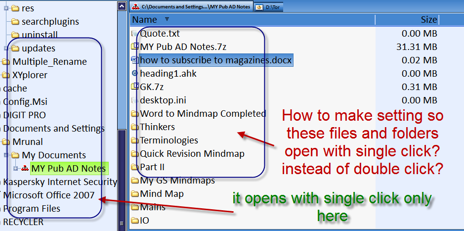

  • How to make it open files and folders with the single click?

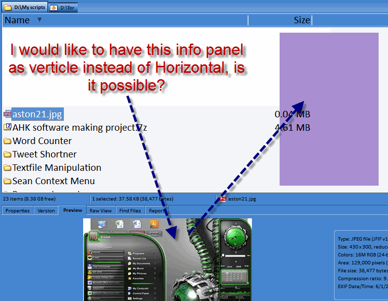

  • How can i've a Verticle info bar instead of the horizontal?
verticle info panel.gif (62.69 KiB) Viewed 3003 times
single click.png (96.74 KiB) Viewed 3002 times

* How to make it open files and folders with the single click?
Well, it's not supported.
* How can i've a Verticle info bar instead of the horizontal?
Not supported again. But you can enlarge the Info Panel by dragging the horizontal splitter between status bar and Info Panel. And you can use F11 (Full screen preview).

there are some tricks that work for me.
1. How to make it open files and folders with the single click?
ans: i found a program that turns the middle click into double click, which you can automatically start with xyplorer by making a batch file.
link - http://www.codeproject.com/KB/cs/MBtn2DblClick.aspx
2. How can i've a Verticle info bar instead of the horizontal?
ans: not possible, but a trick is to use customize file association feature, so that you can fully view the files.

stanmarsh wrote: 1. How to make it open files and folders with the single click?
i recommend autohotkey or hotkeyp (what i use), since they have many other features beside the dbl-click.

Mrunal wrote:* How can i've a Verticle info bar instead of the horizontal?
and then use the toolbar buttons "last IP size" (or right-click the statusbar) and "max IP size" so that you don't have to drag the splitter every time.
