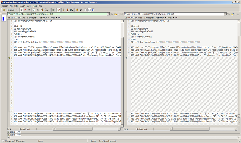

I am not sure I understand, but: have you tried experimenting with the buttons I marked green in the following image?SkyFrontier wrote:Beyond Compare just like everything else does a comparison and skips large blank blocks in the middle and I cannot find a way to toggle this off.
- Controlling what is being displayed/folded in BC
- ForSky.jpg (16.34 KiB) Viewed 6937 times

You were right, guys. I played a bit more with BC and it's definitely the way to go.
Borut: what's the 3rd green-highlighted button caption, please? My version is a 2.x so buttons are a bit different. What's that version of yours, BTW?

3rd green-highlighted button caption: Show context... For a lonely line being different, while the mode "show only differences" activated, also a few neighbouring upper and lower lines are shown.SkyFrontier wrote:Borut: what's the 3rd green-highlighted button caption, please? My version is a 2.x so buttons are a bit different. What's that version of yours, BTW?
-does it have word wrap? I can't find it *anywhere*, on mine...
My BC version is 3.3.5 Pro.
Word wrapping possibility is not known to me and I believe it does not exist. If it does, please somebody tell this to me too.
