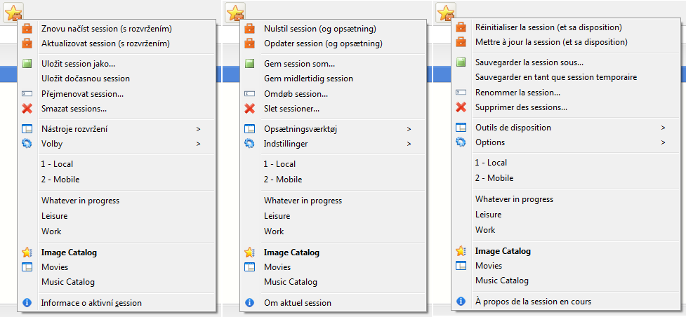

So, let's start with a teaser, Session Manager main menu in    Čeština ( :appl: Hogaty)    /    Danske ( :appl: Regmos)    /    Français ( :appl: Anon.):

• LANGUAGES:
 — Čeština by HogatyUpdated 2015-08-18
 — Dansk by RegmosUpdated 2015–08–03
 — Italiano by Flora_RMCAdded 2015–08–18
 — French: Pending…

* Clarified status info of all Temporary Session operations
* Renamed "– Autosave –" to "•• Autosave ••" in menu for better legibility (esp. if enabled for Temporary Session))
