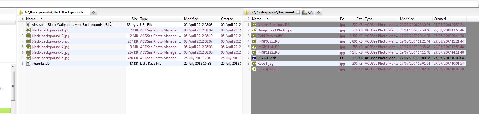

Posted: 19 Feb 2013 08:38
by clarkedesign
I'd like to jump onto this discussion please.
I've got my inactive panel background set to a rather dark grey and have zebra striping turned on.
However this looks awful in my inactive panel with some lines dark grey but alternates white.
I want to keep zebra striping turned on as it helps me to follow the file list row on my wide monitors.
Turning zebra striping off isn't an option as it turns it off in the active pane as well.
I think that we need an option here to either:
- define more colours for the inactive panel
- turn off zebra striping in the inactive panel (whilst leaving it on for the active panel)
- FAVOURITE: dim the inactive panel, irrelevant of colours and other options (so everything looks more faded / translucent)
From reading various discussions around the forum, it seems like quite a few people are having trouble getting the inactive panel to look inactive (me included) and a few more options would help everyone enormously.
