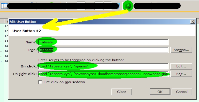

Although this is achievable via scripting (see code box), I would also be happy if this dialog would be expanded in that manner.Steel wrote:It would also be nice to have a dropdown menu with existing Tabsets names in the Save As window cause I have created many Tabsets but don't remember by heart all their names.
Additionally, my wish would be for Tabset dialogs to remember their position and size. I find it easier to select from a dialog then from a MRU and so I would avoid scrolling the list (at least for a while, since the number of tabsets at my place grows steadily - I do not know how I was living without them
Tabsets Save As via scripting (for those new to scripting, please read the help and adapt the script, since your mileage may vary):
"Open... As <get pane> : openas"
global $TabsetBase;
perm $TabsetBase;
tabset("open", "$TabsetBase as: $TabsetBase\<get pane>");
"Save Copy As... : savecopyas"
global $TabsetBase;
perm $TabsetBase;
$TabsetList=listfolder("$TabsetBase", "*", 4, "|");
$TabsetList="Save Copy As New Tabset...;new:|-|" . $TabsetList;
$SaveAsName=popupmenu("$TabsetList");
if ($SaveAsName=="new:") {
tabset("savecopyas");
elseif ($SaveAsName=="") {
status "Save copy as cancelled.", "FF0000";
else {
delete 0, 0, "$TabsetBase" . "\" . "$SaveAsName";
tabset("savecopyas", "$SaveAsName");
"Load Home Tabset As <get pane> : loadhometabset"
global $TabsetBase;
perm $TabsetBase;
tabset("load", "$TabsetBase\0 HOME as: $TabsetBase\<get pane>");
"Show Tabsets Folder : showbase"
global $TabsetBase;
perm $TabsetBase;
status "Tabsets Folder: $TabsetBase";
"Set Tabsets Folder : setbase"
global $TabsetBase;
perm $TabsetBase;
$BrowseFromHere = exists("$TabsetBase")==2 ? "$TabsetBase" : "C:\";
$TabsetBase = inputfolder("$BrowseFromHere", "Select new tabset base folder");

Defining a user button by using an already prepared script file is not too difficult. Here are the steps for my previous scripts (see the appropriate attached image):
1. Create an empty file Tabsets.xys in the "Scripts" subfolder of your XYplorer's "Data" folder.
2. Open it with a simple editor.
3. Copy in it the contents of the code box from my previous post.
4. Save.
In XYplorer...
5. Rightclick on toolbar | Customise Toolbar
6. Add one of the User buttons from left list to the right list (at the position you want it to be). OK.
7. The "White Star on Blue" user button should now appear in your toolbar. Rightclick on it | Edit.
8. Fill with the following (see the image below):
Name... Tabsets
Icon... :tabsets
On click... load "Tabsets.xys", "openas";
On right-click... load "Tabsets.xys", "savecopyas;-;loadhometabset;openas;-;showbase;gotobase;setbase;resetbase;-";
9. OK.
10. Try right click on it and use "Set Tabsets Folder" first. I hope it should all work.

- Defining a user button for using the tasets scripts
- UserButtonDefinition.jpg (111.51 KiB) Viewed 2928 times
