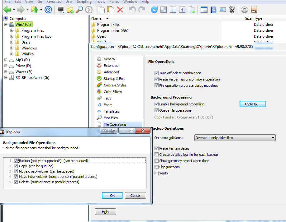

Re: Copy freeze
These are my settings
than I can find concerning background processing
- snap4.jpg (79.77 KiB) Viewed 2428 times

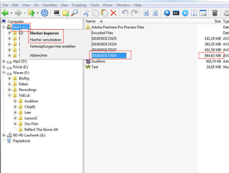

Re: Copy freeze
I right click with the mouse on the file I want to move or copy, hold the right click
drag to the harddrive or folder where I want to copy or move
release the right mouse click
and say move here or copy here
In this example I did it with a big video file from drive F to drive C
and it doesn't matter where I copy or move
or from where.
it is all about when I do it with the right click
and if my harddrive needs some time eith it.
or from where.
- snap1.jpg (45.84 KiB) Viewed 2339 times
- Posts: 65180
Re: Copy freeze
OK, this operation is triggered via the Shell context menu and completely handled by the shell. I cannot intercept it and move it to the background.
I'll make a note in the Help file.
Re: Copy freeze
It seems you've disabled Configuration > Extended > Custom drag and drop context menu. As a result, you only get the Windows Shell-provided context menu, which bypasses XYplorer's handling of file operations.schehf wrote:I right click with the mouse on the file I want to move or copy, hold the right click
or from where.
By (re)enabling the above option, you'll get XYplorer's context menu; when you select one of its Copy/Move options, XYplorer will background and/or queue the file operation depending on your settings in Configuration > File Operations.
