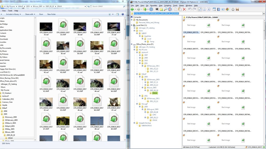

Posted: 16 Feb 2011 13:31
by mikep
Hi There
I am getting a "Bad Image" for all my NEFS (D70, D70s, D80,D90,D200 and D300)
I can view the Files (Thumbnails) in Windows Explorer and also in the F12 Preview Pane (Its comes up with Cannot Decode and then a pause later displays the picture)
What should I do the Enable thumbnails for NEF's ?
Regards

Re: NEFs from D700 show as bad image icon
Posted: 16 Feb 2011 13:38
mikep wrote:Hi There
have you ticked Configuration | Thumbnails | Show thumbnails for non-picture files?
