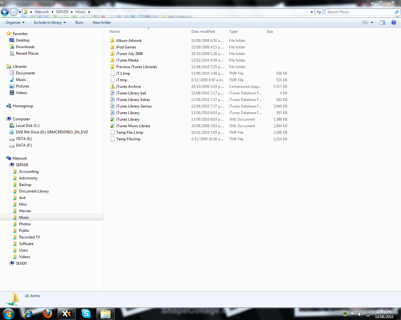

I am having a problem with no files showing in my network with XYplorer v9.2.
The files are visible in Explorer as you can see from the first screenshot. Files in subdirectories are visible.
Older versions of XyPlorer show the files just not the newer version.
Screenshots attached.
Any thoughts?

Re: Network Files not visible in latest version
The files in the folders under this directory are visible just not the top of the tree.
e.g
[\\SERVER\Music] shows no files.
[\\SERVER\Music\iTunes Media] shows all files.
This behavior is consistent across all shares and on all computers accessing these directories with XyPlorer v9.2
Mapping a drive shows the files correctly.
Paul
Well I can see the files in Windows Explorer. I can see and use the files in the directory.
I have tried running XY as admin, deleting permissions etc. I created a new share called \\SERVER\Test so as to not do some file damage. If I did not have rights to these directories...why can I see the files in Windows Explorer and with XY v 9.0.
I just don't know what to do...I am pulling my hair out over this one.
Paul
Paul

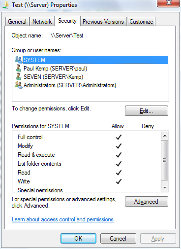

Donald,
What would be the best way to test permissions on the folder?
Paul
Paul
Paul Kemp
Auckland, New Zealand
- Posts: 65244
Go to the folder, then select menu Edit / Show All Items in Branch.Pulinski wrote:How would you like me to do that?
- Posts: 65244
Right-click the folder and check out the security tab.Pulinski wrote:Donald,
Paul
Yeah...I've been doing that.admin wrote:Right-click the folder and check out the security tab.
Any suggestions on a work around?
Paul
