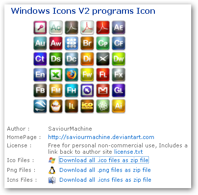

Icon/ICL Downloads:
http://www.iconempire.com/iconlibs/computers.htm
http://www.nesoft.org/free_icon_gallery.htm
(18 ICLs from nesoft as ZIP, f.ex. at http://www.freeware-tipp.de/freeware-do ... 1732.shtml)
http://www.coolarchive.com/icons.php

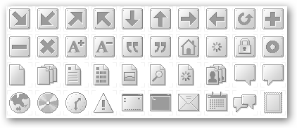

Just found an nice resource for Icons as ico files:
http://www.veryicon.com/icons/application/
http://www.iconeasy.com/ --------------
http://www.iconlibrary.com/
some are free, archive includes numbers and abc icons as ICL's
http://e-lusion.com/design/greyscale/
Greyscale is a set of 40 greyscale icons which each fit into a 34 x 34 pixel area. Yep free icons! --------------
