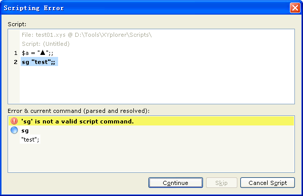

Test 1:
    $a = "▲";
    msg "test";

Test 2:
    $a = "▲▲";
    msg "test";

Raw view of the first test file in MBCS system:
2009-8-23 23-55-20.gif (4.42 KiB) Viewed 1636 times
My guess: You can see the MBCS string '$a = "▲";' takes 10 bytes in the raw view, but there are actually 9 Unicode chars after it's read into memory. Extra chars (from next line) will be read if using the byte number to break lines.

Thanks, really interesting! I forgot that there are Unicode that resolve to 2 chars when converted to ANSI.
Looks like I have to rewrite a couple of heavily used functions.
