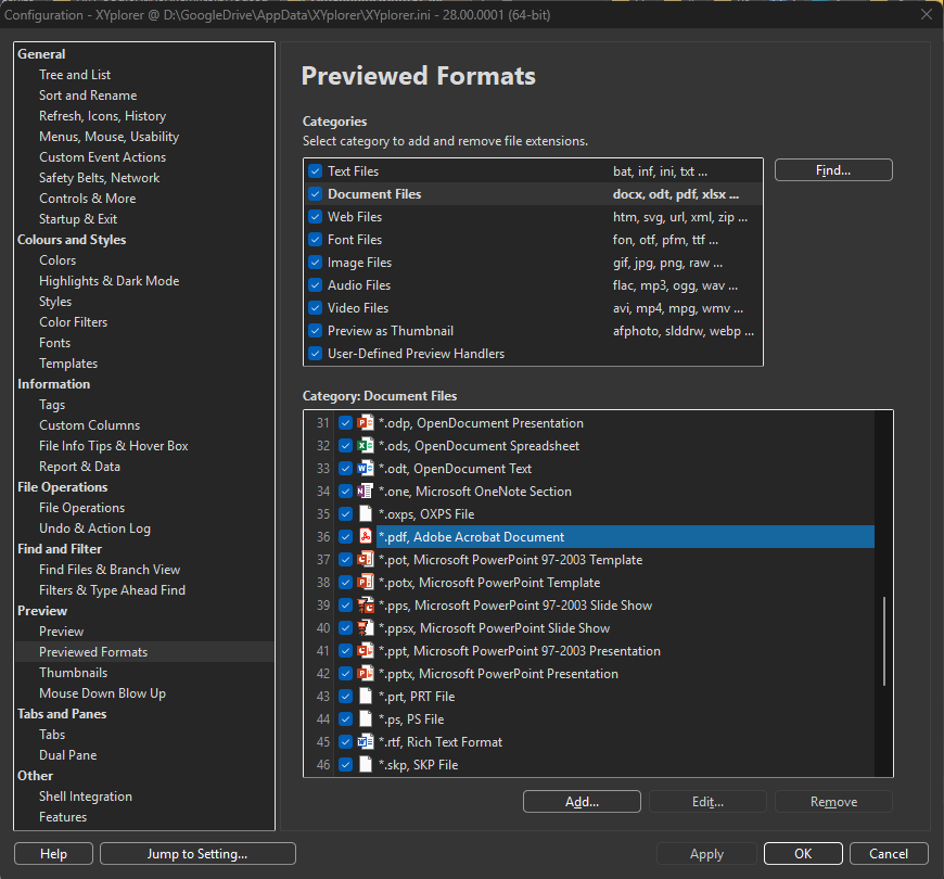

Hi there
I am trying to preview some PDFs using XY's floating pane (F11). However, when I do so I get the message "No Preview Available". I have Adobe installed and I think it is configured correctly:
2025-10-01 13_41_08-Configuration - XYplorer @ D__GoogleDrive_AppData_XYplorer_XYplorer.ini - 28.00..png
Any ideas of what might be up?
thanks
Ach

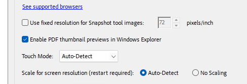

Posted: 02 Oct 2025 14:59
by acheton
Right, after a bit of googling, it appears that x64 preview handlers are not installed by default but you need to select this option to do so:
I've done this and it is now working fine. thanks for a pointer in the right direction Don.
