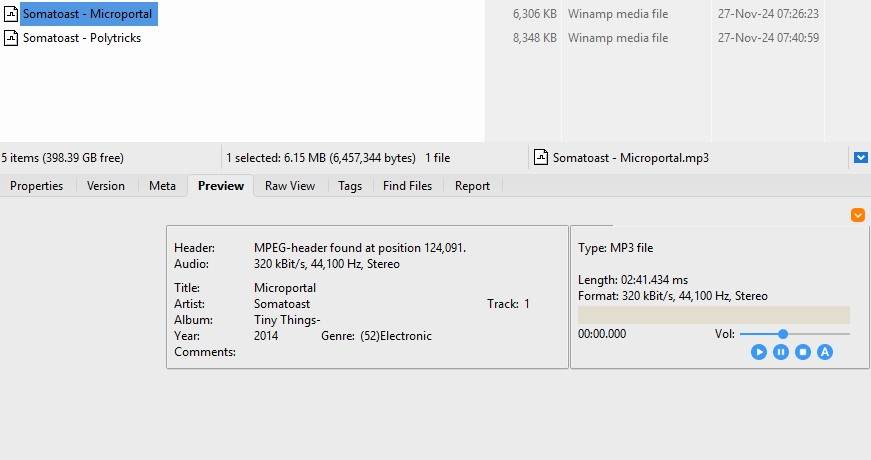

I've searched the forum and have come across related subjects but i cannot for the life of me explain why two, seemingly similar, mp3's should have different preview behavior in XYPlorer.
- Some mp3's use the XYPlorer preview with all the details and the mini player. (1.jpg)
- Some mp3's use an embedded Windows Media Player (Legacy) in XYPlorer as a preview. (2.jpg)

I have use MediaTool to compare the files and there are slight variations between these two example files. But it also happens with many other mp3 files which are all different.
Anyway, I'm stumped. Am I overlooking something obvious?

Follow up: I found out the reason why this behavior occurs and it's easy to verify.
It is directly linked to the filesize of the embedded cover in the mp3 tag!
The cut-off seems to be 120kb. If the embedded cover is larger than this, XYplorer no longer uses the regular preview but falls back to WMP.
For my test I also uninstalled WMP (thinking it might be related to this) and the affected mp3 files are now "previewed as thumbnails".
(And no, mp3 is not listed under Previewed Formats > Preview as Thumbnail)
Is this a DirectShow thing or a XYplorer thing?
