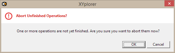

You should see this:
Works here.

I see nothing. I close the main window via the X-button and both the main and the copy window simply close without further notice.
