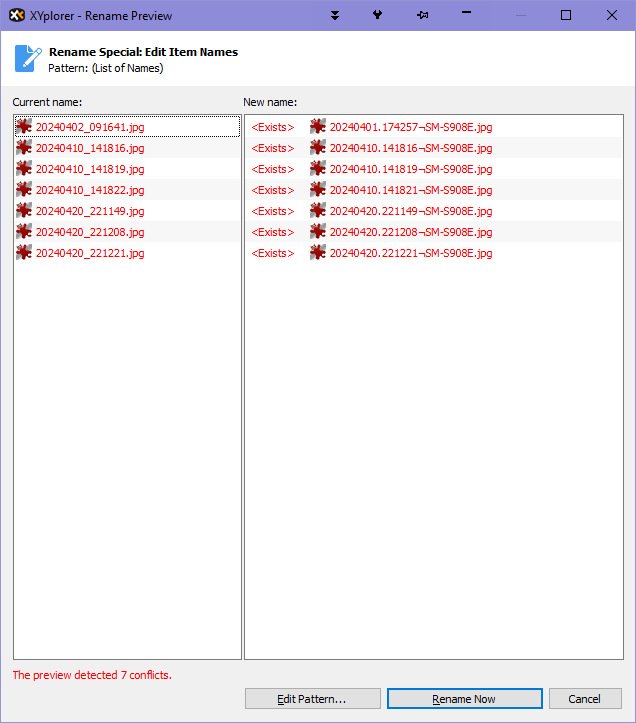

However, at times, there will be a conflicting filenames, due to same EXIF date:
I've already contacted highend privately, but I still cannot figure out on how to do that.

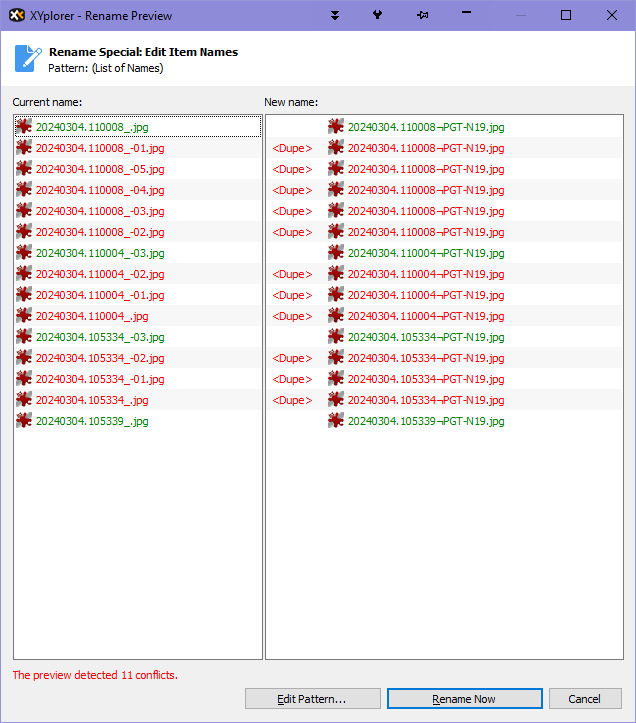

But sorry.. Is it possible to cater the scenario whereby.. The existing file already exists (previous batch renaming).
So it will come out like this.
Is it possible to rename those automatically with the duplicate extension?

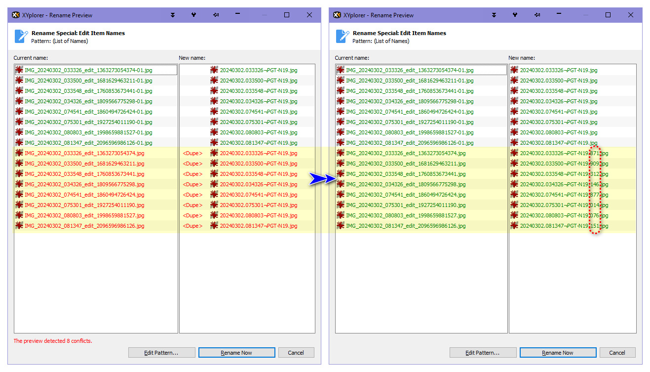

Actually I forgot that I want my filename to be this format actually:
Thank you so much.
