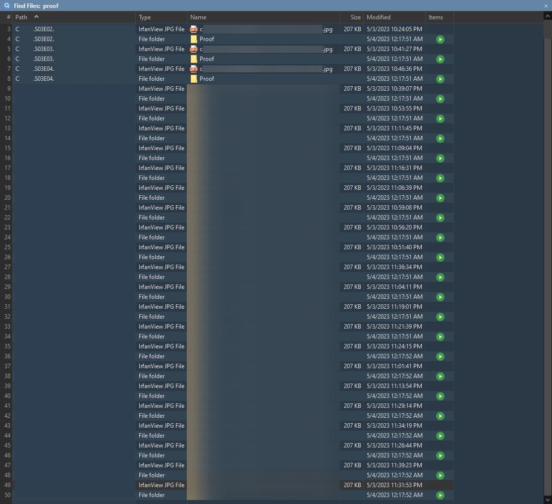

Is it possible to move multiple files of a certain name to their own respective subdirs, all in a single action?
Or is there a native XY feature that might assist in this operation?
Use case (see screenshot):
I currently run a simple search to isolate the files and folders I wish to work on then drag+drop each individual file into their own subdir but this is very tedious and hardly seems efficient.
If someone smarter than I is able to write a script to automate this process I'd appreciate the help.

Question: What are we supposed to learn from your screenshot?
Some sample files and folders with full names might go a long way in finding a solution (if you can't share the real ones, make some up that show the way this should be done).
Your description is a bit vague.

RalphM wrote: 04 May 2023 07:31 Question: What are we supposed to learn from your screenshot?
The OP screenshot illustrates a standard "Find" query and the items to be moved (*.jpg's located in each folder's root, the only files present in the screenshot) and the respective subfolders each image is to be moved to (*\Proof).
This method of isolating the relevant subfolders and files to be moved is as efficient a way as I've found, at least much more so than moving in and out of each individual folder one at a time.
Currently, moving each item to their respective subfolders is achieved by simply dragging+dropping each individual .jpg into the "Proof" folder beneath it in the "Find" results, which is acceptable when working with only a few files but becomes an inefficient process as the quantity increases.

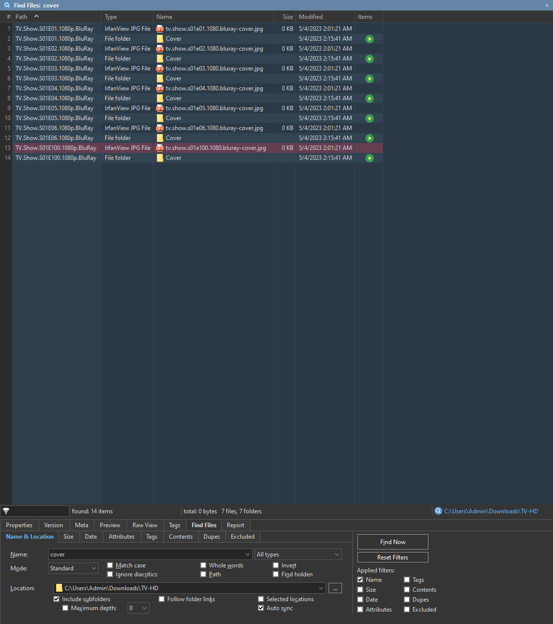

Another example:
DESCRIPTION: items returned after a "Find" query for items named "cover" isolates a collection of cover.jpg files and "Cover" subfolders present in each parent folder.
ISSUE: each cover.jpg needs to be moved to their folder's respective "Cover" subfolder.
CURRENT SOLUTION: drag+drop each cover.jpg to their own corresponding "Cover" subfolder, which is an inefficient process for moving anything more than a few files.
Performing this process on a series of 500 folders or even just a fraction of that, but performed daily, is not optimal.

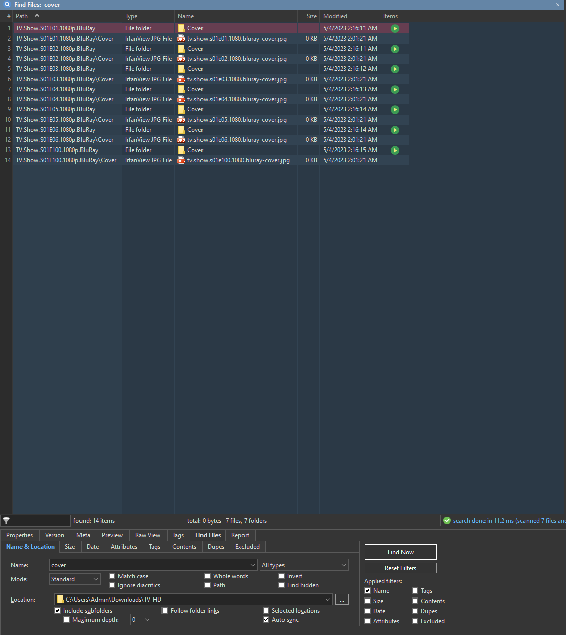

Here's a screenshot after manually moving each cover.jpg to their respective "Cover" subfolder (as you see in the "Path" column).
I'm inquiring as to whether a script could mitigate this manual process or if there's a native XYplorer feature built-in that could assist in this operation.
I could even see a Windows batch script possibly aiding in this operation but I'd need help from brighter minds.
Any suggestion to help automate this process of manually moving individual files into their respective subfolders would be appreciated.
