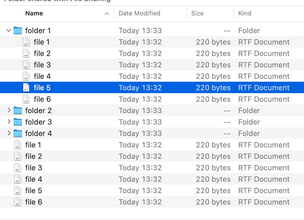

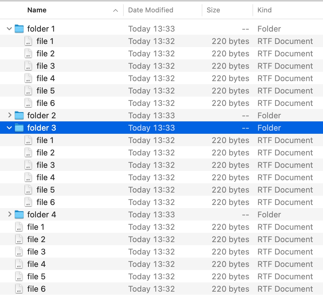

For the screenshots i've created a folder. Inside that folder i've places 6 files and 4 subfolders. I've copied the same 6 files inside each of the 4 folders
I'm attaching 3 files:
ej1.jpg: Detail view inside of the main/master_folder with every sub_folder collapsed (this is a standard in every file browser)
ej2.jpg: Sub_folder 1 expanded in the same view
ej3.jpg: Sub_folder 1 & 3 expanded in the same view.

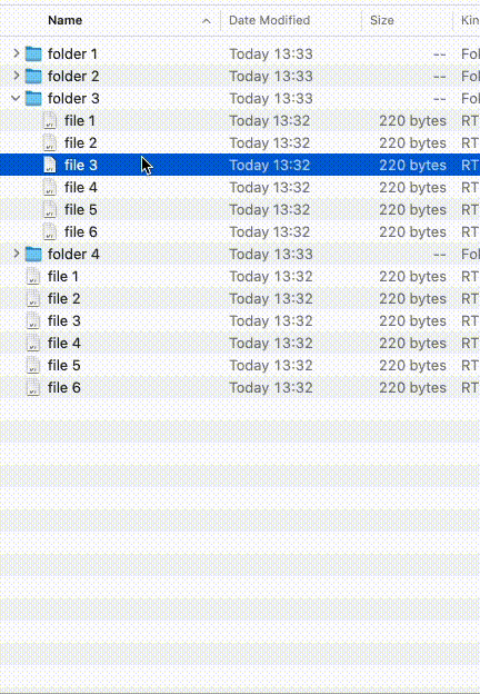

- Posts: 15016
Re: Expand/collapse folders inside the detail view
Expands only the selected folders!
The animation shows that the not-selected folder 1 & folder 4 are not expanded while the selected 2 & 3 are expanded

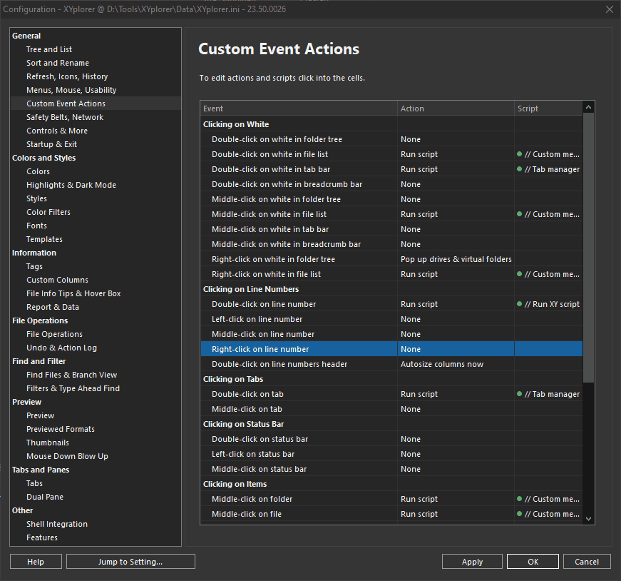

- Posts: 15016
Configuration | General | Custom Event Actions
you could use the event "Clicking on Items -> Middle-click on folder"
or "Clicking on Line Number -> Left, Middle or Right-click on line number" (one of them)
use "Run script" as the action and enter the script after clicking on the column entry on the right...
Sure, could be scripted as well (the filter would need to be changed and reapplied, the branch view itself wouldn't be touched).
After using the script?And one last question, is there also a way to collapse one of the open folders?
