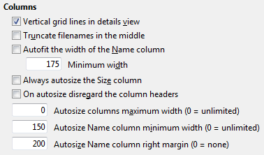

You might give this a try: Configuration | Colors and Styles | Styles | Columns | Autofit the width of the Name column

But other than "Configuration | Colors and Styles | Styles | Columns | Autosize columns maximum width (0 = unlimited)" this should only apply to the Name column, right?

E.g. Min name column width: 250
Now when names are longer that would fit into these 250 px the column is enlarged but when you switch into a folder / tab where all entries would be below this value, the column width stays at 250 px instead of being reduced further
Would love to see that as well because I was never lucky with the autoresize feature that can make the name column too small...

Done. :cup:

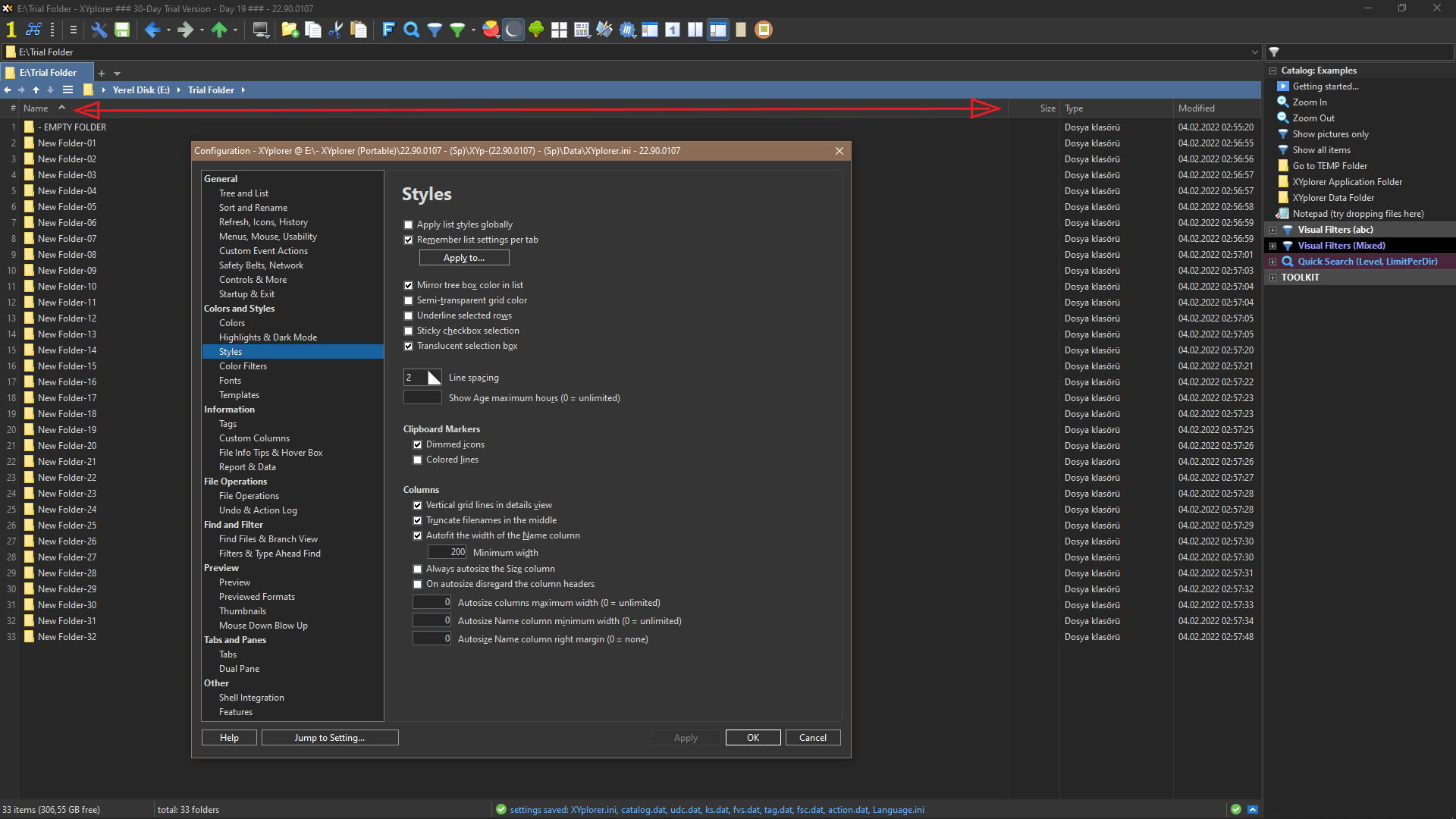

So I think it would be good to add the "maximum width" setting for the Name column as well.
I will be glad if you accept. :)

MindReader wrote: ↑08 Mar 2022 16:58 I don't want to stop using "Autofit the width of the Name Column".
You should, because "Autosize Name Column Right Margin" is much better IMO. Try it.
Just use higher value than 200.

xy123 wrote: ↑08 Mar 2022 17:12
I tried with the setting you mentioned in the list with many columns.
Both with and without "Truncate filenames in the middle".
Yes, after a few tries, the appropriate one can be reached.
But the length of the name column is determined indirectly.
Therefore, when switching to another folder, the setting may not be appropriate, that is, it is not flexible.
If, as I stated;
(In a list with many columns,)
(In case of using "Autofit the width of the Name Column" and "Truncate Filenames In The Middle".)
If "Maximum Width" setting is added for "Name column", "Name column" will be set directly.
Also, I think it would be a more flexible setting.
If accepted, this feature will not affect anyone negatively as it will be optional. :)

@MindReader: I like the idea. Makes total sense. :tup: Next beta...
