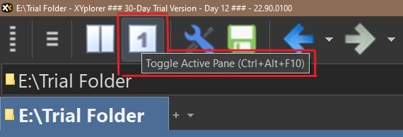

1) We activate the desired panel with one click.
2) We can also see which panel we are on from the number on the button in the Tolbar.

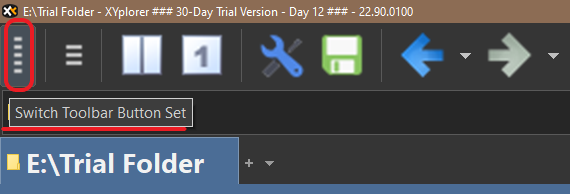

The property in "1)" has been applied exactly to "Toolbar Button Set".
However, feature number "2)" is not available in "Toolbar Button Set".
I would be happy if you could show the numbers indicating the set it belongs to on the "Switch Toolbar Button Set" button.
Thanks.

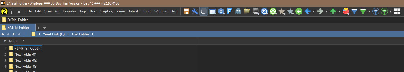

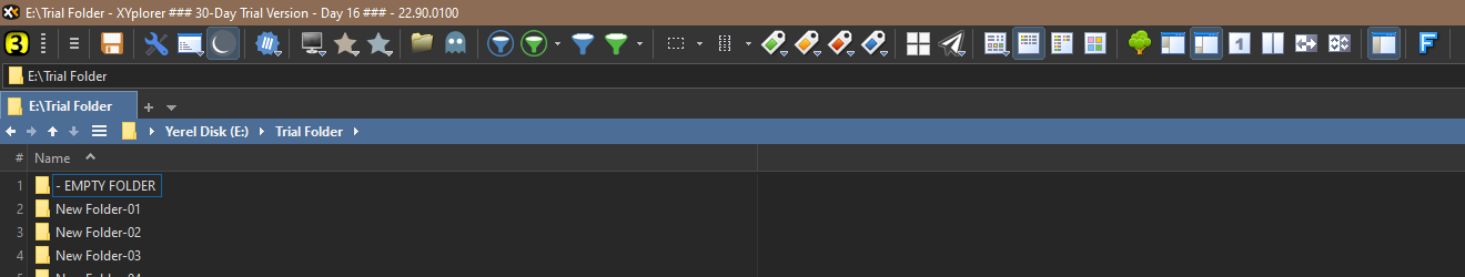

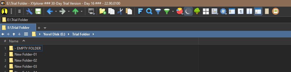

I added a "User Button" to each toolbar.
I also defined symbols containing numbers for the buttons I added.
(Thanks to @kunkel321.) :appl:
Thus, I can easily understand which toolbar I am on.
You can see it if you look at the pictures.
I don't think it looks bad. :)
However, it does not contain the function, :(
It contains information only.
I don't think it's necessary to put the numbers on top of each other.
It is enough to show only one of the 4 different numbers.
As you click, the numbers will change and define the toolbar it belongs to.
I think this is possible.
(This is how the "Toggle Active Pane" button works.) :whistle:
Thank you for your interest.

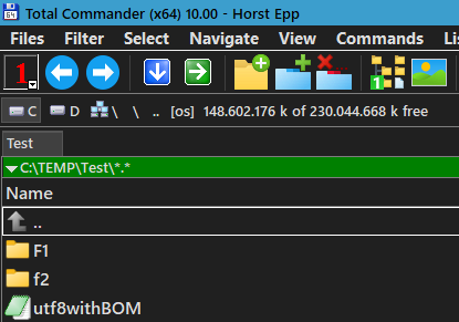

I like it and have similar design in my Total Commander setup.
Pressing the number button shows a pull-down with the other available toolbars and I can press one of it of course.

Horst wrote: ↑05 Mar 2022 22:31 I like it and have similar design in my Total Commander setup.
Thank you for explaining that you agree with me. :)
