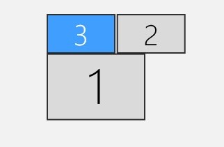

Monitors layout is asi following on the picture 1:
Monitor No. 1 is Surface (2736x1824), which screen I have set on 200 % zoom.
No. 2 and 3 are standard office 21" Benq monitor (1920x1080).
No. 3 is set as the main screen.

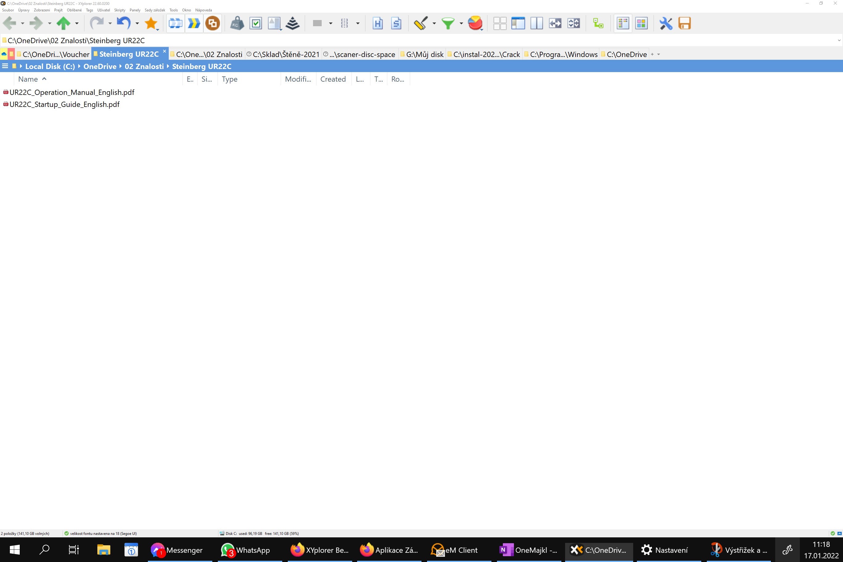

On the screen no. 1 (Surface) resolution of XYplorer is not correct.
I am able to zoom icons of toolbar, text of files and folders, but I am not able to zoom text of menu bar and status bar and icons of folders and files.
