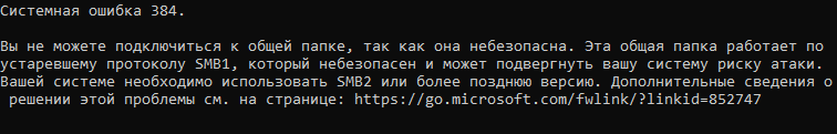

The message is notifying me that some of my SMB-shares is using SMB1 protocol (old and unsafe).
The first line should be:
Системная ошибка 384.
XYplorer displays:
С????мна? о????а 384

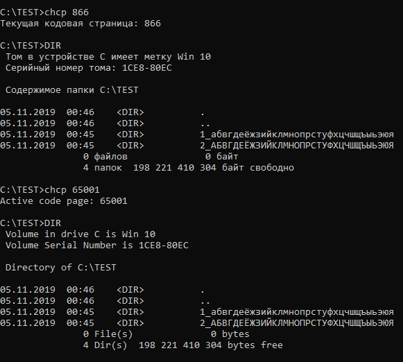

Here's how the output should look like (for some reason when switching from 866 to Unicode
Windows switches from Russian to English text):
Windows Command Prompt

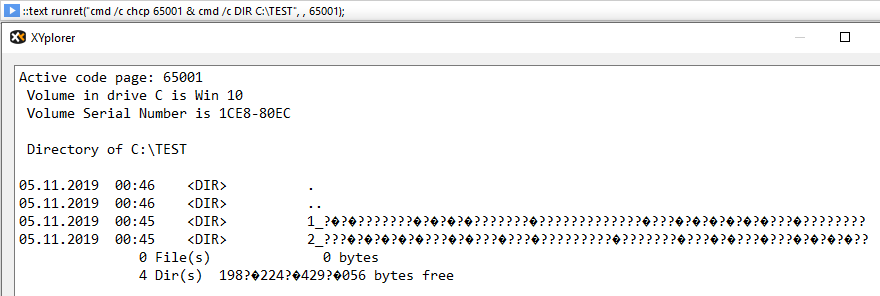

Here's the output in XYplorer
text runret("cmd /c DIR C:\TEST");
text runret("cmd /c chcp 866 & cmd /c DIR C:\TEST", , 866);
text runret("cmd /c chcp 65001 & cmd /c DIR C:\TEST", , 65001);
default
default
866
866
65001
65001

Windows Command Prompt (CMD) Settings default (and current) encoding: 866 OEM Russian
CMD
CMD

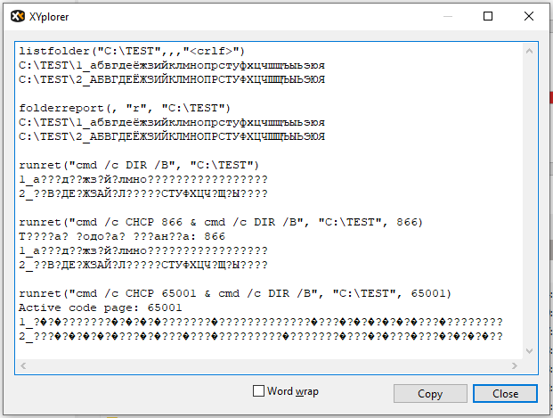

I've downloaded a new copy of XYplorer (No-Install ZIP), here's what I get with the default settings.
Code (with labels for easy reading):
text
 'listfolder("C:\TEST",,,"<crlf>")' .<crlf>. listfolder("C:\TEST",,,"<crlf>") .<crlf>.<crlf>.
 'folderreport(, "r", "C:\TEST")' .<crlf>. folderreport("dirs", "r", "C:\TEST") .<crlf>.
 'runret("cmd /c DIR /B", "C:\TEST")' .<crlf>. runret("cmd /c DIR /B", "C:\TEST") .<crlf>.
 'runret("cmd /c CHCP 866 & cmd /c DIR /B", "C:\TEST", 866)' .<crlf>. runret("cmd /c CHCP 866 & cmd /c DIR /B", "C:\TEST", 866) .<crlf>.
 'runret("cmd /c CHCP 65001 & cmd /c DIR /B", "C:\TEST", 65001)' .<crlf>. runret("cmd /c CHCP 65001 & cmd /c DIR /B", "C:\TEST", 65001);
Result:
C:\TEST\1_абвгдеёжзийклмнопрстуфхцчшщъыьэюя
C:\TEST\2_АБВГДЕЁЖЗИЙКЛМНОПРСТУФХЦЧШЩЪЫЬЭЮЯ
1_а???д??жз?й?лмно?????????????????
2_??В?ДЕ?ЖЗАЙ?Л?????СТУФХЦЧ?Щ?Ы????
Т????а? ?одо?а? ???ан??а: 866
Active code page: 65001
1_?�?�???????�?�?�?�???????�?????????????�???�?�?�?�?�?�???�????????
2_???�?�?�?�?�???�?�???�???�?????????�???????�???�?�???�???�?�?�?�??
Screenshot:
RUNRET
RUNRET
XYplorer has no problems with LISTFOLDER and FOLDERREPORT.
But when using RUNRET, some Russian symbols are messed up, while other symbols are displayed correctly.

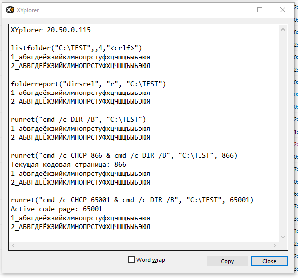

The fix helped. Thank you.
Sample:
Script:
text
 'XYplorer ' . property("fileversion", "<xypath>\<xyexe>").<crlf>.<crlf>.
 'listfolder("C:\TEST",,4,"<crlf>")' .<crlf>. listfolder("C:\TEST",,4,"<crlf>") .<crlf>.<crlf>.
 'folderreport("dirsrel", "r", "C:\TEST")' .<crlf>. folderreport("dirsrel", "r", "C:\TEST") .<crlf>.
BEFORE:
AFTER:
