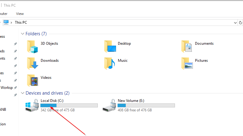

Posted: 30 Mar 2019 17:35
alfi286 wrote: ↑29 Mar 2019 14:20 2. Double click drive C
Where do you double-click?
Re: Default file manager stops working properly after a while
Posted: 01 Apr 2019 12:31
by alfi286
I have attached a picture of where I double click.
