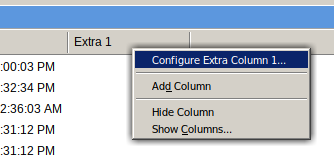

If you're going to use tags, your best option is an Extra Column of the "popup list" format.
Add an extra column with Menu > View > Columns > Extra #. (one of "Extra 1/2/3/4/5" which is available.)
Right click on the newly added Extra # column header, and click Configure... .
Now in the configuration dialog, set up the column like this:
Caption:      Machine
Type:         Pop-up List
Pop-up list:  (Enter machine names here, one in each line.)
              HAAS VF-3
              HAAS VF-4
              HAAS VF-5
              HAAS VF-6

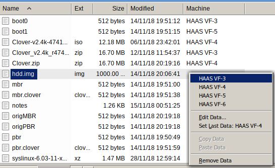

Okay. Now you can right click on the "Machine" column of a file and tag it with appropriate machine model
(hint: multiple files can be selected to apply the same machine tag to them at once).
Now, you can search by this Machine field like this:
  • in address bar: ?Machine: "HAAS VF-3"
  • in find files panel: Machine: "HAAS VF-3"

Yes! This is exactly what I intended. It is important that I make the system easier to use for the not-so computery guys. Being able to add the machine attribute to the file on the fly is perfect. I also made a "Material" column using the same method. As you can see I don't use the tree, so I have plenty of room for columns. Thanks!
