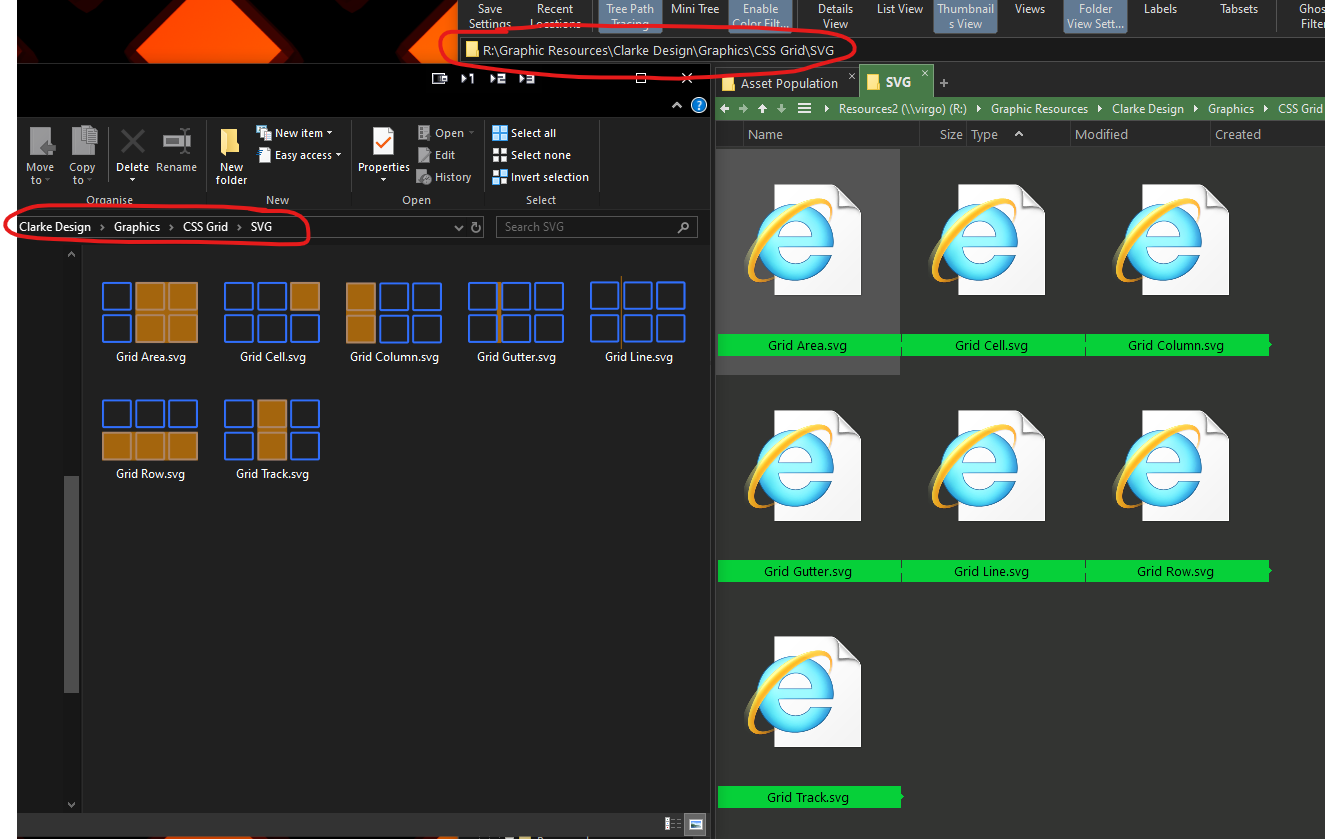

I've read the above port and have installed BOTH versions of the SVG Expolorer Extension.
Rebooted etc...
SVGs now display fine in Windows Explorer but do not display at all in XYplorer.
Are there some other settings that I need to set or configure somewhere.
Rebooted etc...
Thanks,
Sean Clarke
Sean Clarke

- Posts: 69
- Joined: 14 Feb 2013 09:29
Re: Thumbnails for SVG only works for some files
This was and is still checked.
But SVGs do not create thumbnails.

- Posts: 69
Gave this result
GUID: {4CA20D9A-98AC-4DD6-9C16-7449F29AC08A}
FriendlyTypeName: @C:\WINDOWS\system32\ieframe.dll,-914
Thanks,
Sean Clarke
Sean Clarke

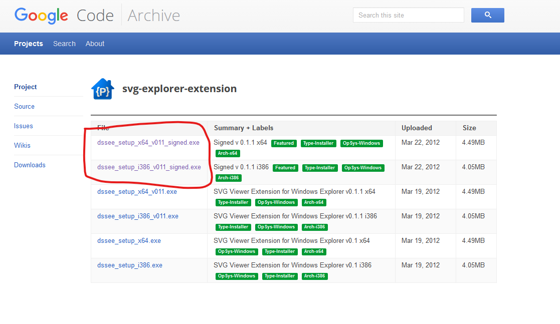

When you say the x86 version. Can I just make sure that we are talking about exactly the same thing here.
I've downloaded and installed both of the following files from the Google Code Archive.
https://code.google.com/archive/p/svg-e ... /downloads
- dssee_setup_x64_v011_signed.exe
- dssee_setup_i386_v011_signed.exe
Thanks,
Sean Clarke
Sean Clarke
- Posts: 63689
Do you have a link to that x86 version?
FAQ | XY News RSS | XY Bluesky
