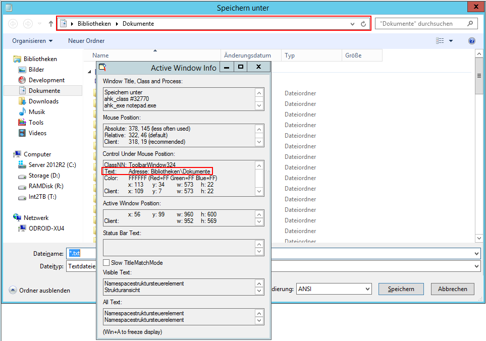

Maybe you should have posted which tool you are using...
What you need is the text in the upper control. E.g. I'm displaying a Save as... dialog here.
"Bibliotheken - Dokumente" is the current path
The tool that shows the details is the spy utility from an AutoHotkey installation. As you
can see in the red surrounded part it displays:
Text: Adresse: Bibliotheken\Dokumente
while hovering over the upper control in the Save as... dialog.
That's where the "Adresse" in the .ini file comes from.
In your screenshot I can't see: RAMDISK anywhere in your "window controls displaying utility"
so I don't know how the Chinese? translated part looks like (and if it is even on the left / right side)...

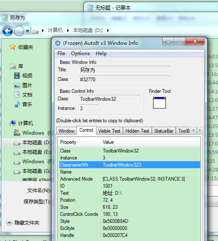

Re: quick switch to active path of XY for common dialog such as "save as ..."
Posted: 26 Feb 2018 02:35
by zanjero1
class:ToolbarWindow32
classNN:ToolbarWindow323
Posted: 26 Feb 2018 07:22
by highend
This:
Text   <some chinese characters>: D:\
