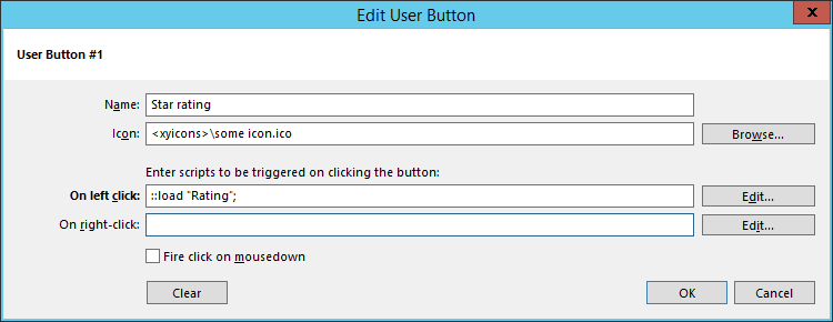

The code for a button to load the script could be:
::load "Rating";
