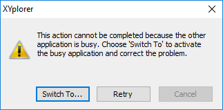

Hi, just a little nudge on this thread.
I've had this problem sporadically for a while. Usually 2-3 times a week but it can be up to 10 times per day.
It definitely does happen when trying to preview Office docs, but I've had it with other files too.
In the attached screenshot it is happening with a PNG.
Contrary to Abdulk, I've found getting rid of this window quite frustrating. The fastest way is to keep clicking "Retry", and after about 20 clicks the window disappears and the preview loads. Clicking any button in the dialog box causes the window to close and then instantly reappear.
It's a bit of an odd one. As Filehero said, it seems to occur quite randomly.
I'm running Windows 10 64-bit on a desktop and laptop, and this error occurs the same on both devices.
Thanks Don.

Re: Error: This action cannot be completed because the other application is busy
Posted: 25 Feb 2018 12:32
The preview pane is not visible in the screenshot. I suppose it is open on the right-hand side?
