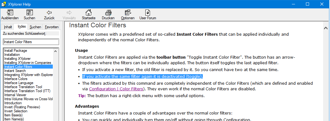

is there a tweak to stop the toggle if the same value is set (is it a bug)?
This is by design
Instant Color Filters
Usage
ยท If you activate the same filter again it is deactivated (toggle).

The help says :
If empty ("") any color filters are deactivated.
I was a little surprised that it toggles.
The toggle feature isn't mentioned in the help, but I can see the UI works in a similar way on the dropdown, selecting the same dropdown item toggles the instant colouring off/on.

I was looking in the scripting commands help section : colorfilter but it only appears to be mentioned in the index page (linked in the colorfilter description) just didn't notice the " If you activate the same filter again it is deactivated (toggle). "
btw: if I search for "instant color filters" it doesn't return the index page you have shown because its part of the "color filters" page, guess I thought it would have its own page.
Selecting on the index tab, searching for instant color filters it finds the page..
