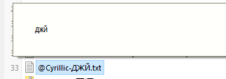

Text files encoded in UTF-8 with Cyrillic symbols are shown like this:
By the way, Preview tab on Info Panel looks the same:

MDBU on a file that contains ДЖЙ
works fine here.
Standard UTF8
Did you try it with UTF-8 BOM / UTF-16LE BOM?

highend wrote:Did you try it with UTF-8 BOM / UTF-16LE BOM?
UTF-8 with Signature — fine. Unicode BOM — fine too. UTF-8 — still bad.

This should be ticked if the files have no BOM:
Configuration | Preview | Text preview | UTF-8 auto-detection

admin wrote:This should be ticked if the files have no BOM:
Oh. Thank you. Problem solved.
